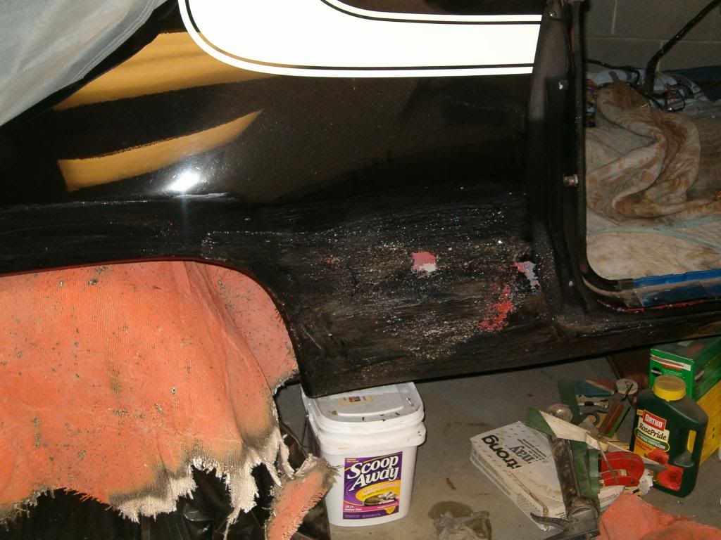

Is it damaged or rotted or both? If it is solid but damaged I would just fix it.I love your car by the way...

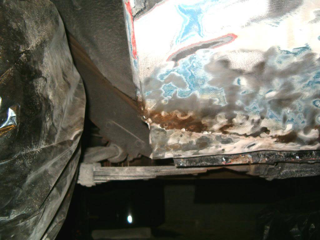

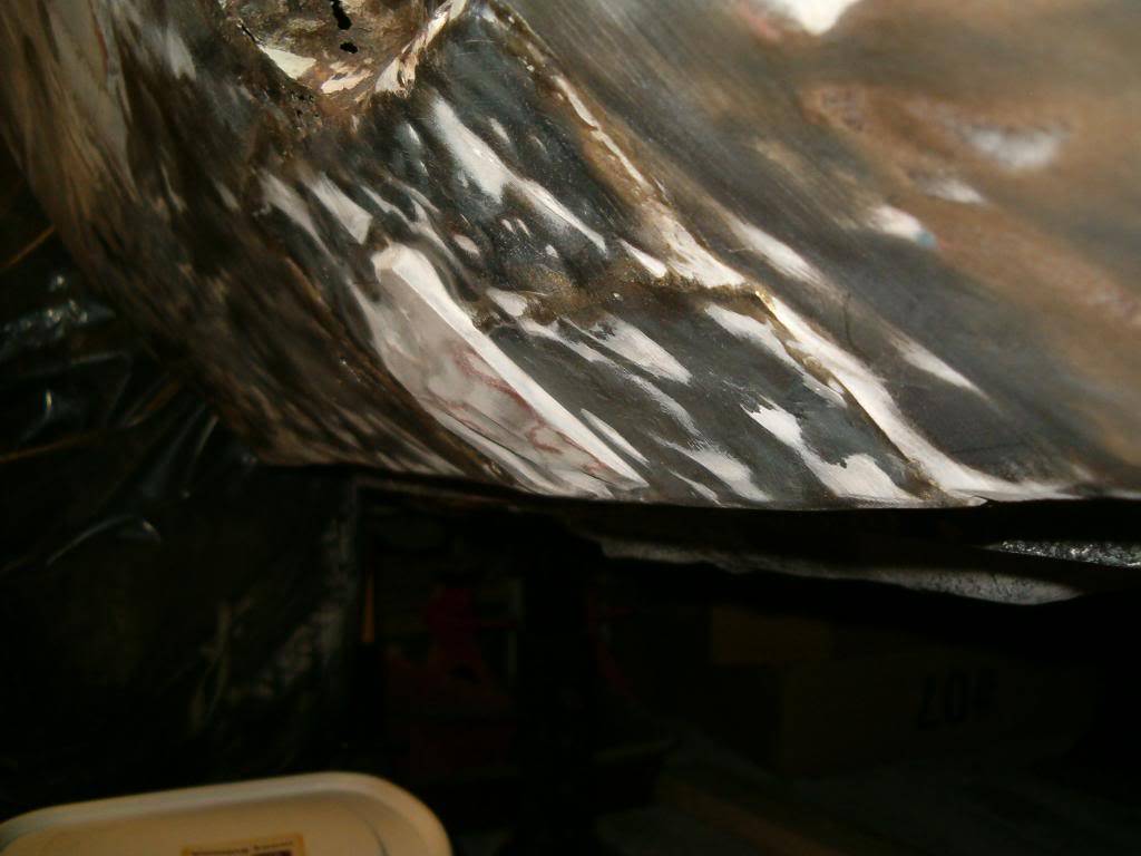

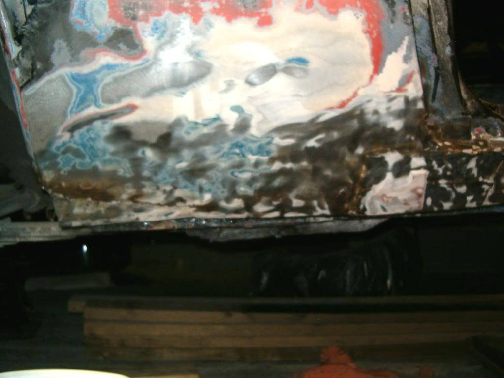

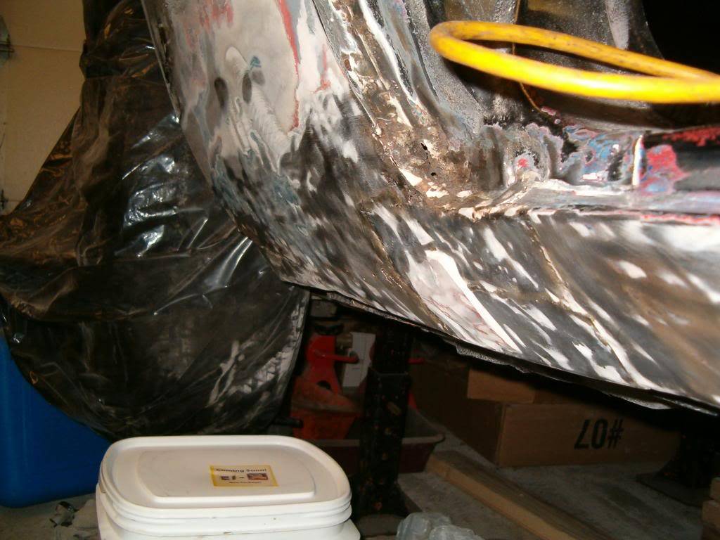

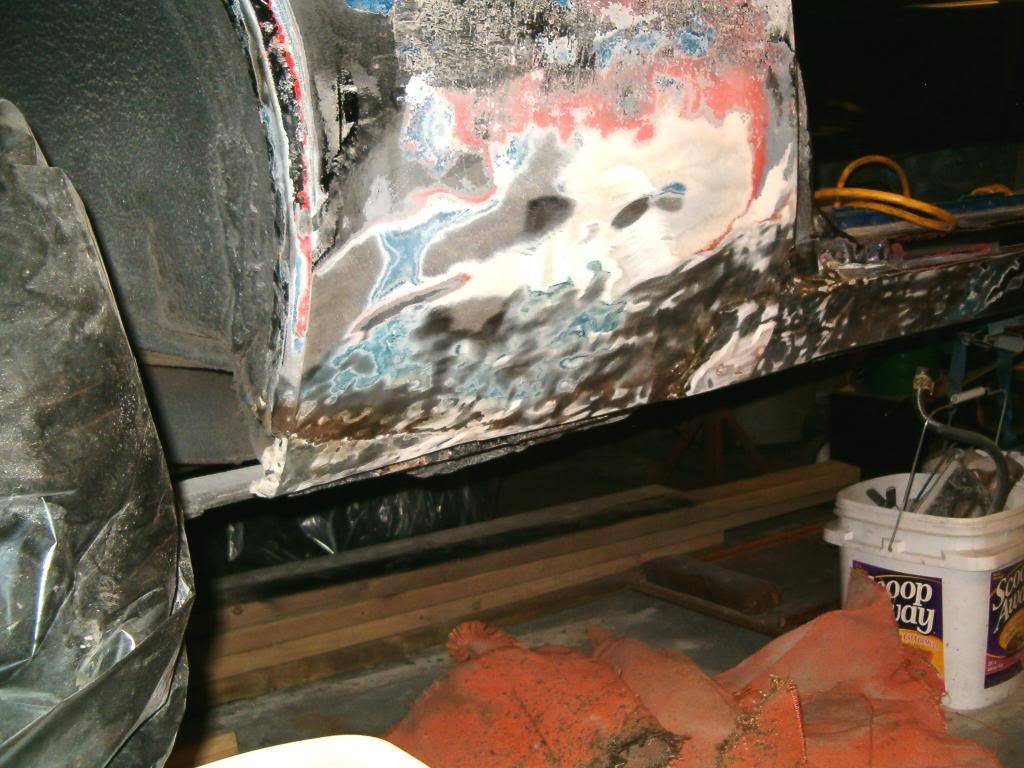

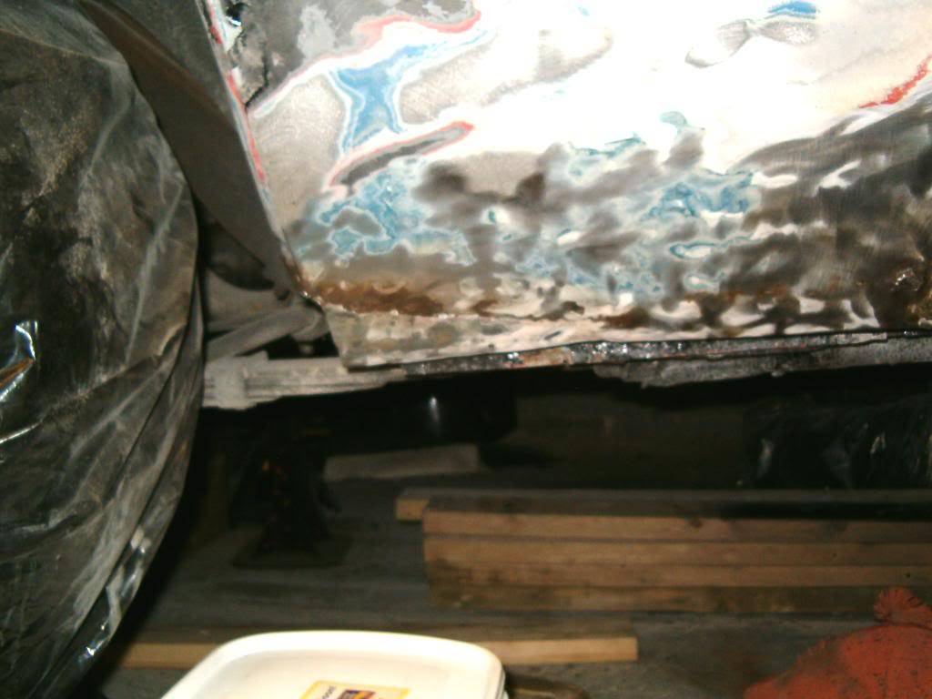

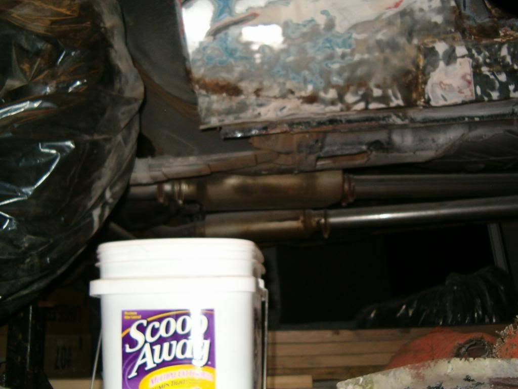

here is what im dealing with . there was a ton of bondo in the lower 1/4 and rocker ill be cleaning putty dust in the garage for the next 10 years at on place on the 1/4 there had to be at least 1/2" of build up .

I pretty much gave up hope on finding quarters for mine, looks like yours are in slightly better shape than the ones in my car, I think my bondo runs a smidge deeper. I'm just keeping my eyes open, and will probably end up salvaging some full quarters off of a car from out west. Pretty much anything can be better than what PA did to these cars when they were new.

yep i remeber you and your runner . if it means anything i called AMD AUTO METAL DIRRECT yesterday they told me they have been looking for a set of 1/4s so they can tool up and start repoing them they said dont expect anything for about a year or so .
so keep your fingures crossed .
I would just section a piece of sheet metal in. Do you have a mig ? and can you do bodywork ? If not, take it to a good bodyshop.
