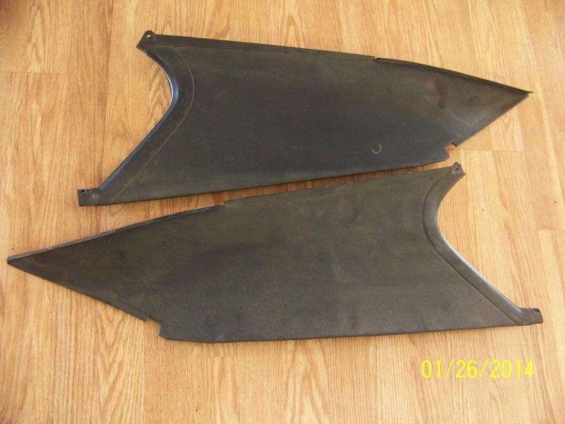

pictured sail panels are 71/72

Panels that do not interchange are the ones for some of the 71/72 Chargers, as seen in the photo of my covers in your original post. These have the long, forward, curve on the front, while the later B bodies were straight up and down at the front. I was told by the person I bought those from that they were for all B bodies, but when I took them out of the box I immediately saw that the rear part would fit, but the front is totally different.

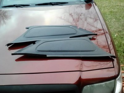

Now that we've likely confused the Hell out of Montclaire, let me ask this: has anyone seen a molded plastic sail panel cover for any year charger that is shorter than the ones shown in these posts? I know I haven't. The only panel covers I've seen that are shorter are the ones maid of cardboard that have to be covered in fabric and are not molded plastic.
Of the molded plastic ones I've seen, there are three types. These are for Chargers:

Has anyone seen a shorter, molded plastic, cover?

I think he posted those just for reference about what is what he meant about sail panels, but not being specific about that shaped panel
I think these might be what I am looking for. They do not look like 73/74 plymouth. I think the middle pic above might be charger SE? There is a lot of confusion regarding these. There must be a trim piece that attaches to the leading edge of the fiber board version?
Those look like 71/2 Plymouth and yes there is a metal molding on the front that holds the glass seal.
