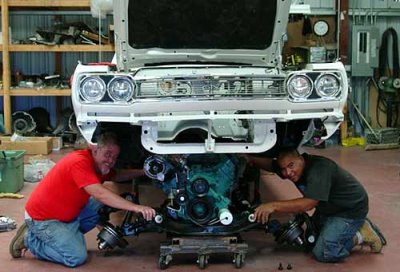

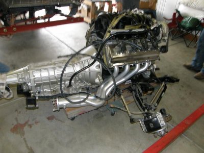

Yeah, that's the way the factory assembled them and there are no clearence issues either. here is a pic of some guys actually having fun doing it! Good luck!

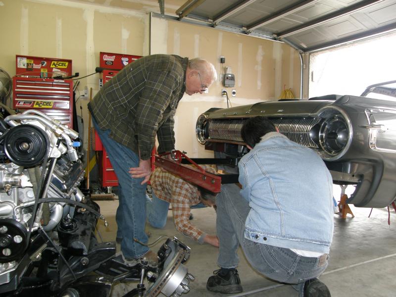

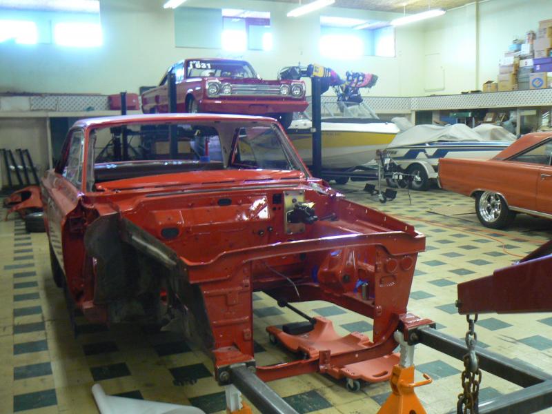

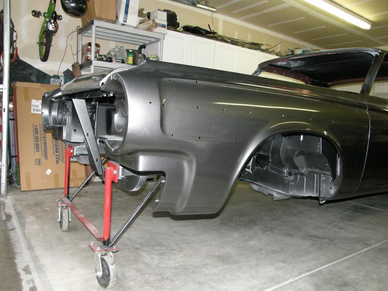

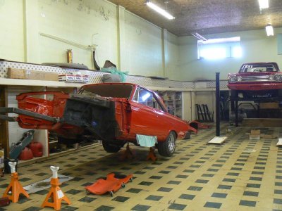

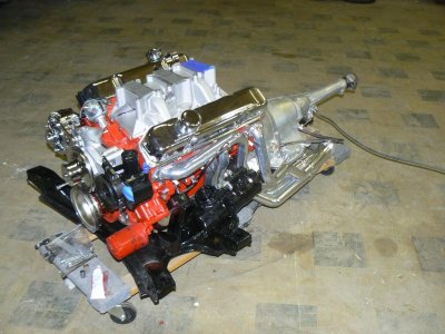

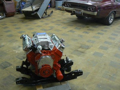

Engine/trans install
My father and 2 buddy's helped me install my combo 1 month after I had eye surgery, so I was snapping the pics and they did the grunt work. Also, the lift and roller set I made for my car is now being used on my dad's 70 rt challenger.
