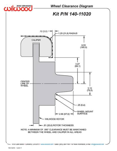

Depends on whether you're talking the 14" ones or the 15" ones.
What’s the caliper clearance on the wheels? Center of hub to inner drum or rim
You'll be fine then.
It even says it in the description: "The manufacturer advises the use of a 14" or larger wheels."
Wildwood 4 pots will clear, 6 pots I would be concerned about.
Wilwood’s will not work on magnum 500 wheels, the Wilwood hub will hit the center cap of the magnums. I have pictures I will post up.
Can you not grind it back? its a fairly chunky cap.
It’s the retaining clip that holds the cap that will not fit. You can actually use a spacer that will push the wheel out a little further. That will change your backspacing though.
