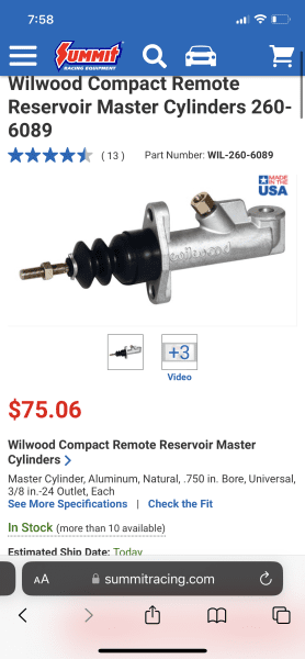

As suggested on several threads on this site, I'll be using a Wilwood master cylinder to replace the one supplied by SST for the hydraulic clutch in a TKX conversion into a 64 B Body. My research leads me to the above Wilwood number (260-15098) - see link - Wilwood Disc Brakes
Could someone who may have done this confirm that this is the correct part. Thanks, Charlie.
Peek at my previous posts for more detail but; .750” if you want a heavier pedal with shorter throw and the .625” if you want a lighter pedal with longer throw.
