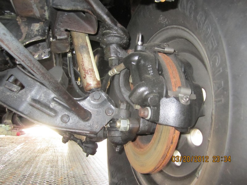

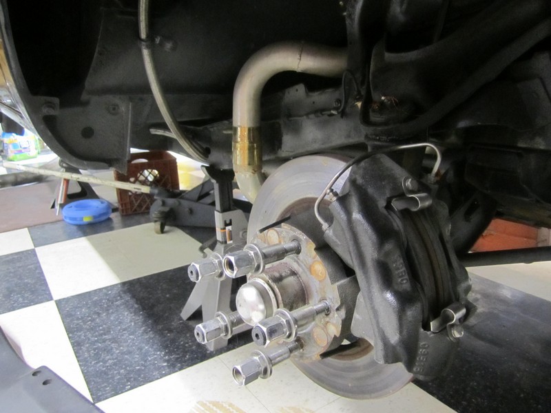

My sled is almost 3900 lbs.Had 6 cylinder front drums & dana rear drums,was ok till about 125 MPH and threw an alternator belt. Didn't realize how much I relied on the engine brake and had an issue stopping in time to turn off at the LAST exit at Englishtown.
I went with the SSBC basic kit with an iron 4 piston caliper and non vented calipers.Now stopping at 140 MPH with no problem turning the key off at the stripe!
