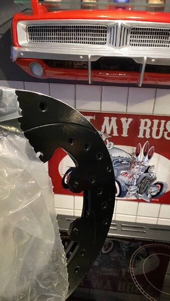

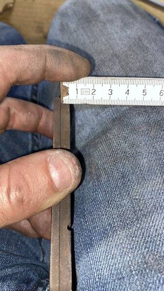

Anyone know’s about the rotor wear or when it’s time to change it if the slot in the rotor are no more visible ?
I not found real statement from wilwood it self ...
First picture is actual rotor after Just 8000 Miles , can be wear it out at this short mileage ?
Second and third picture are Same rotor in new .

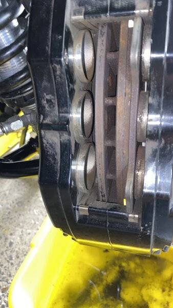

and my pads have pad s have about 1/4” inch left to the back steel plate .

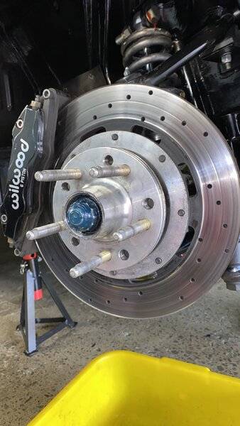

On photo number 4
but on number 5 picture you see all the my moparshop install the caliper on the wrong side , so the bigger piston is in entrance of the rotor and not on the outlet of the rotor like the instruction manual .
Maybe the wrong installation of the calipers are not only gives me less brake power , and also more wear to the rotor and pads itself ? what you think guys . 560451D0-3069-4261-A98D-56F197227A7E.jpeg 62473FE0-F864-4D6A-B1FF-C802EDFC3949.jpeg
I think you should find a different repair shop and a different brake company.....
Contact Wilwood, they will be able to tell you minimum rotor thickness
