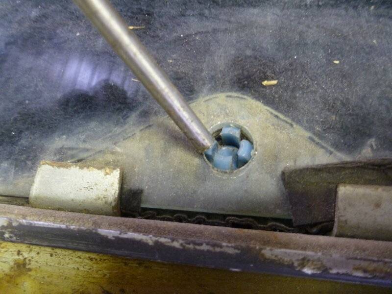

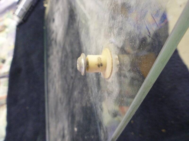

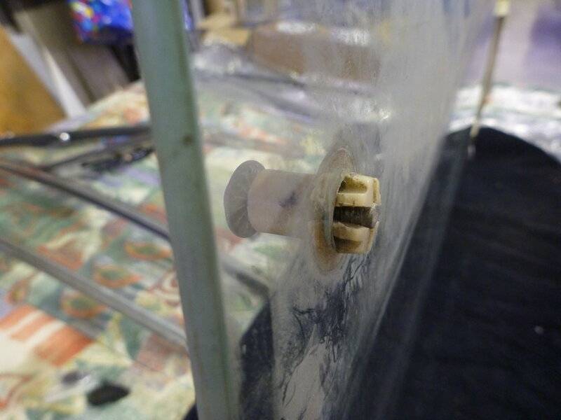

Thanks for the incite Wayne; I appreciate it. But where is the stop? I can't seem to figure out what is stopping the window's down motion.
Oi! I was hoping that wasn't the stop. Looks like the center pin will push through, and then the plug should come out pretty easily? (someone out there is laughing at the "easily" part).

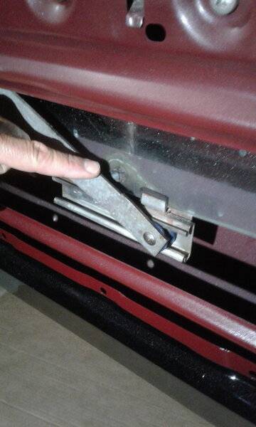

I might be getting my wires crossed. You mean this?....

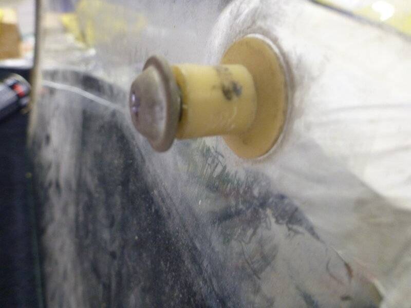

No.. I was just showing that's the only one that I think should have a pin in it... the stop is a screw. Remove the screw and the stop easily removes from the glass. Rear lower corner of the glass...
Ok, it must be different on a '68. I don't have that stop pin. Not a biggie - I'm thinking I can just take the three screws out that hold the regulator, and drop the whole assembly a little bit.

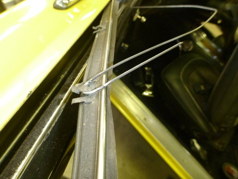

Ah, another good hillbilly coat hanger trick.. I like it. My old ones are already out, but it may come in handy for the next time I have to pull a set out.
