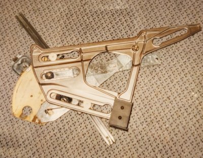

Hello,

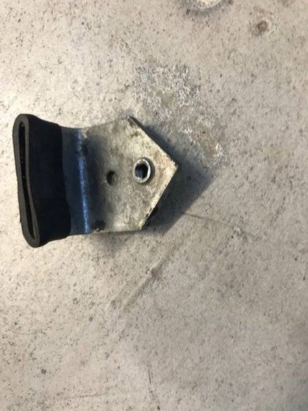

Need some help here. Doing the final details on the restoration of my car and have (2) Window stops (assuming this is what they are) that I'm not sure if they go on the door window or the rear quarter window and precisely where (see attached photos)? I'm at the tail end of a 4+ year restoration and although bagged all parts related to this portion of the car, not remembering where these stops go.
Any help here would be appreciated.
Best regards,
Wayne

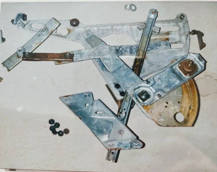

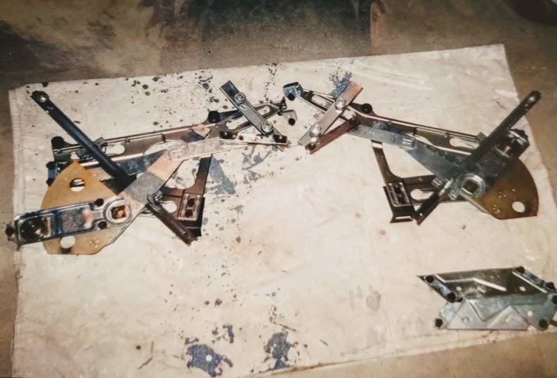

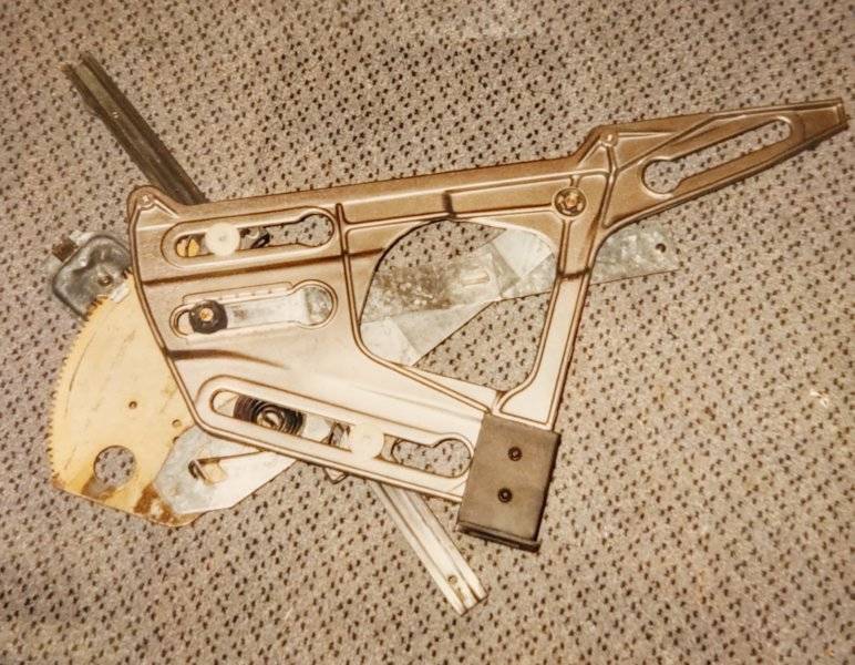

These are from my bird, mid '90s...1st pic is unrestored, removed from the car, and laid out as assembled (kind of). That "stop" you are referring to - there are two for each, if you look closely, is associated with the protruding pieces on the mechanism. I hope these help. Pic 2 is restored, and pic 3 is both left and right front laid out.

Rear quarter window stop.
View attachment 917324 View attachment 917325 View attachment 917326
Thanks the photo on your restored Quarter Window shows it clearly. Appreciate it!

Needing a bit more help here. As I starting to look at putting the window stop on the rear Quarter window it turns out they are already on the rear Quarter window. The ones in the picture sent above have two bolt holes, but the ones I'm trying to locate only have one. Anyone know where these ones go?
Any insight helpful.

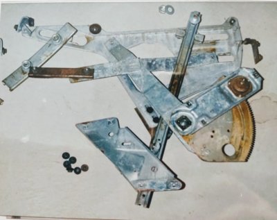

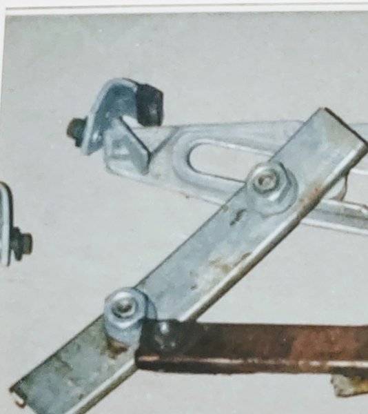

I believe that one is shown on the very top left of the first picture I posted. I think that's the single bolted one you are trying to locate. (I thought I was sending you pics of the front window assemblies, but it's been 25 years.)
