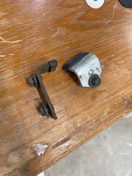

Can you guys provide me with any pictures of where the two stops on the rear quarter windows go? I got the regulators installed but did not figure out where the stops mount. I assume these would go on after window installation?????

Funny I only have to “Up Stops”….
There's a down stop on the window regulator. Looks similar to this one.
You loosen the nut and turn the screw one way or another. It's an eccentric (oval) shape that allows for a lower or higher adjustment. Your FSM should have the details for your year and model.
