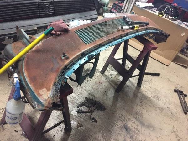

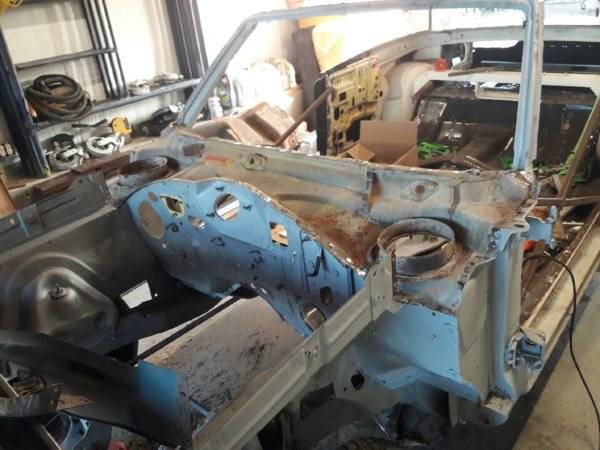

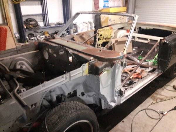

Replaced the one on my 70 due to rust in the window gutter. Just drill the spot welds all the way around, couple mig welds need to be cut too. Was a lot easier to have the good one cut free of the donor car to drill out. Also got to prime and paint under the cowl while it was off.
