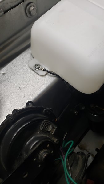

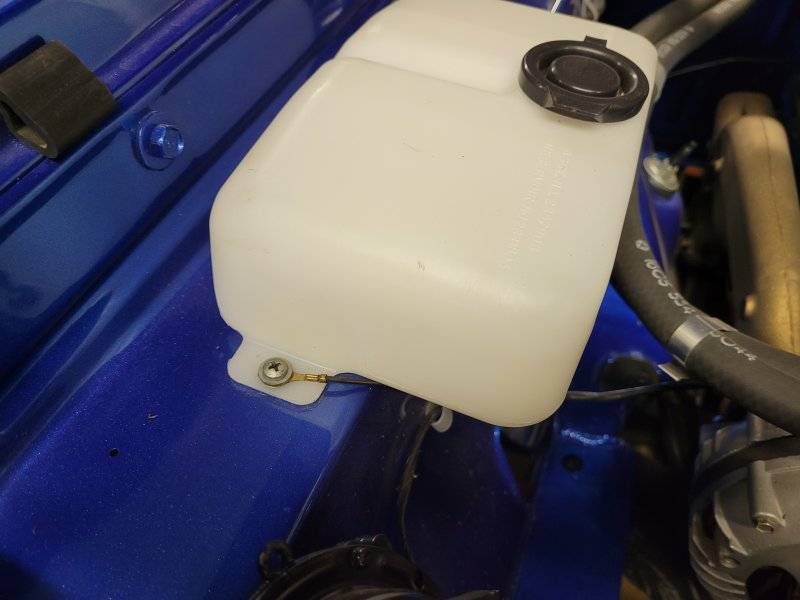

Since I'm relegated to the shop to watch hockey..not positive on the washer..let me find the Bird's.

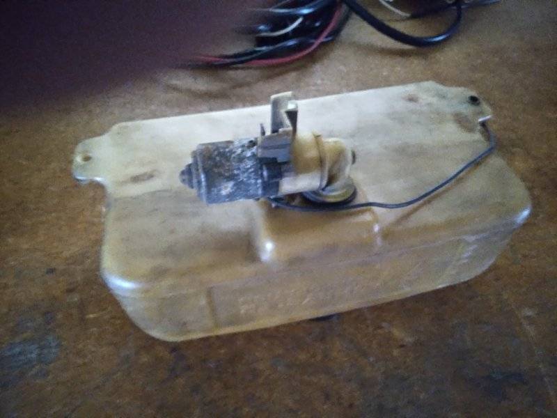

That's where it's at on my 70 Charger. Mine is underneath not on top like Wayne's.

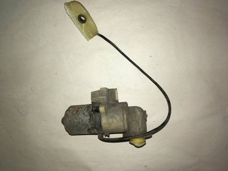

The factory wire has a terminal that was crimped to the plastic tab of the washer jug so it would ground with the mounting screw installed.
Original off my brothers 70 Coronet. Unfortunately the jug was badly cracked so I just salvaged the pump and cap.
