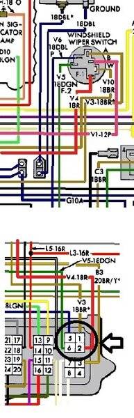

On a 1974 charger, does anyone know or have a picture of the wiring on the back of the switch showing where they connect in reference to the wiring harness and wiper motor. Thanks in advance....
pistolgrip
valid for 72/74 and also 2 and 3 speeds
