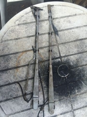

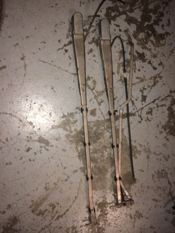

There are a few differences, the main one being in 74+ some of the BBodies sprayers were integrated onto the arms themselves. (IIRC 71-73 never did)
Here is a pair I have from 74 and another pair from 78
So Basically if you are not worried about sprayers and just want the wipers Arms 71- 78 will all work?
