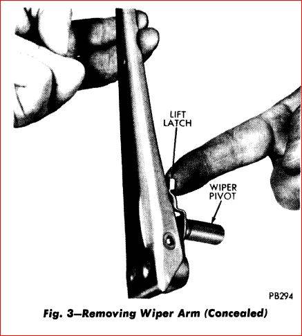

Purchased a 71 Charger and it didn't have either of the wiper arms installed. I was able to purchase a set but struggling to get them installed. There appears to be a black plastic grooved tip on each side. Assuming this stays on and does not get removed. The driver side has two arms that attach, one normal size and one smaller. Seems like it should be pretty straight forward, but can't get the arm to seat all the way down, and can't get the smaller arm to stay in place. Thanks for any help that you can lend. Also, if anyone has any pictures of what they look like when properly installed, that would help as well. Thanks again.
If they are like the 73 there is a small lever that has to slide to the open position before you can pry the others off.
