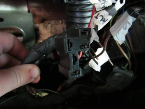

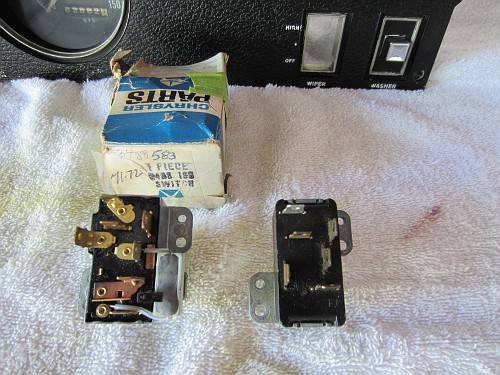

My old two-speed wiper switch's terminals on the back look different than the ones on the three-speed switch. There is one additional terminal on the three-speed switch and two of the terminals on it are in different places than ones on my old two-speed switch. This new three speed switch plugs into the existing under-dash connector, but I believe two of the switch's terminals aren't connected to anything.
Do I need a different under-dash connector to make things right? Will the three-speed switch work OK as-is?
