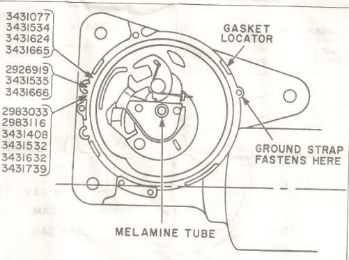

One of the differences between A, E, B or C body wasn't the motor (which was the same) but the clocking of the cover plate, depending on application.
