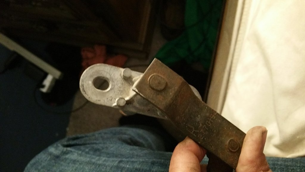

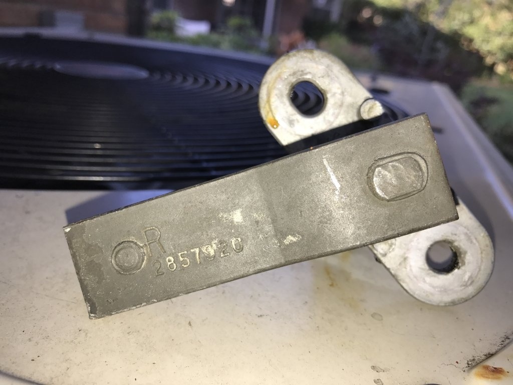

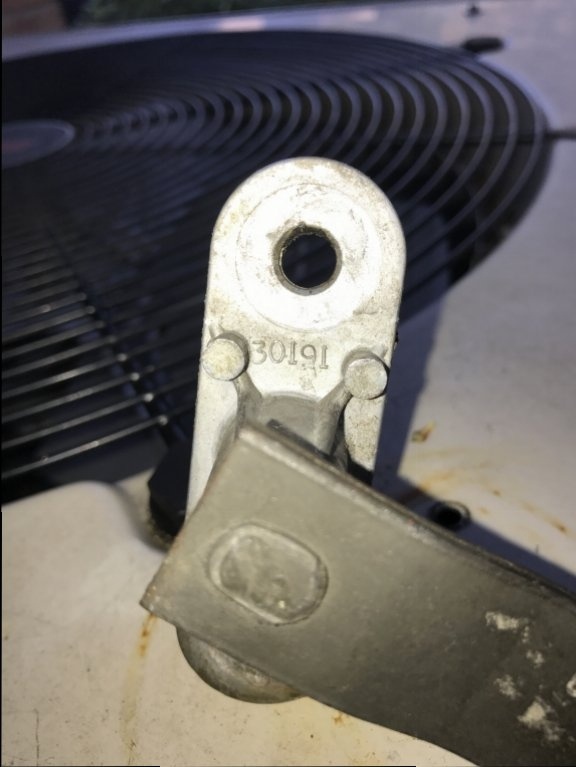

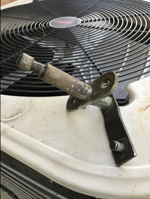

Here is the passenger pivot that I need:

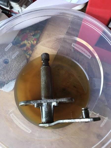

Have you tried soaking it in Evaporust? I've used the stuff on quite a few things to unrust, and the stuff works wonders. Just in case you cant find a replacement pivot

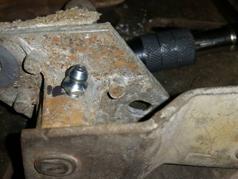

Take it out and add a grease fitting in the side and grease it 99% of the time it will free up. Good time to do the wiper pivot seals also.
I have one that's good, $20.00 plus shipping. Should fit in a small flat rate box for $6.00

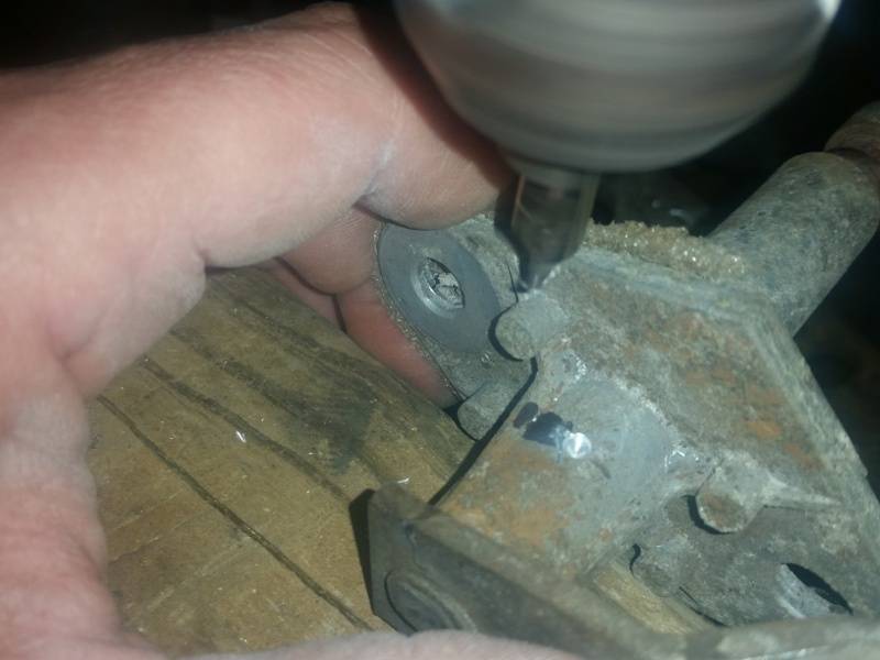

This is copied from my build thread . . . adding a zurk fitting to the wiper pivot shafts . . .
( I made sure that the fitting would be pointing downward so it could be accessed after the car was back together - that's the black mark )

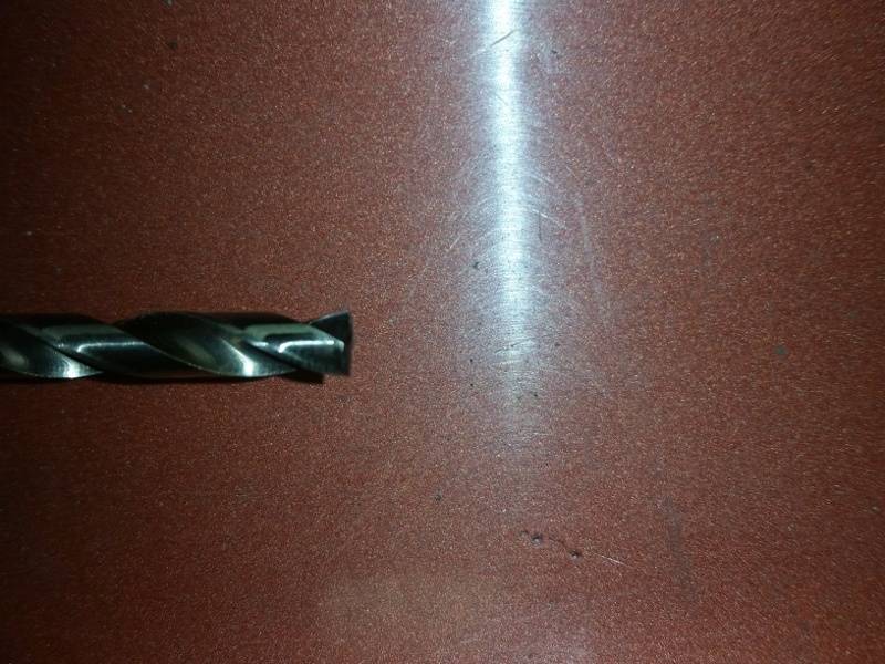

Center drill the location . . .

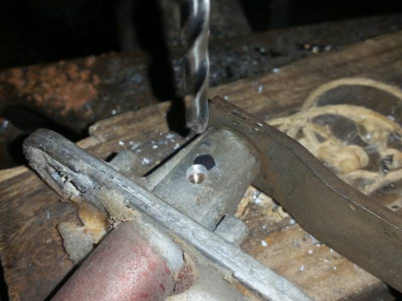

Drill the hole till you touch the shaft . . .
Grind the point off the drill bit to get more of the hole cleared . . .

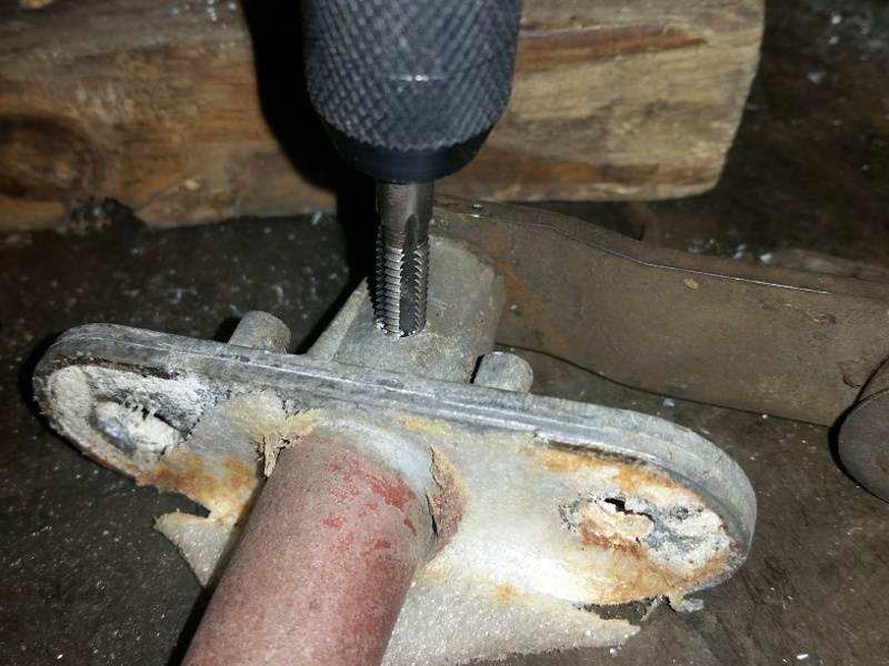

You'll have to grind ( or cut ) the end of the tap to get the treads to cut . . . then tap it . . .
And lastly . . . install the zurk fitting . . . ready for grease . . .
I found 75% ATF and 25% acetone works great.
