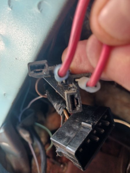

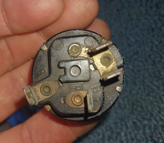

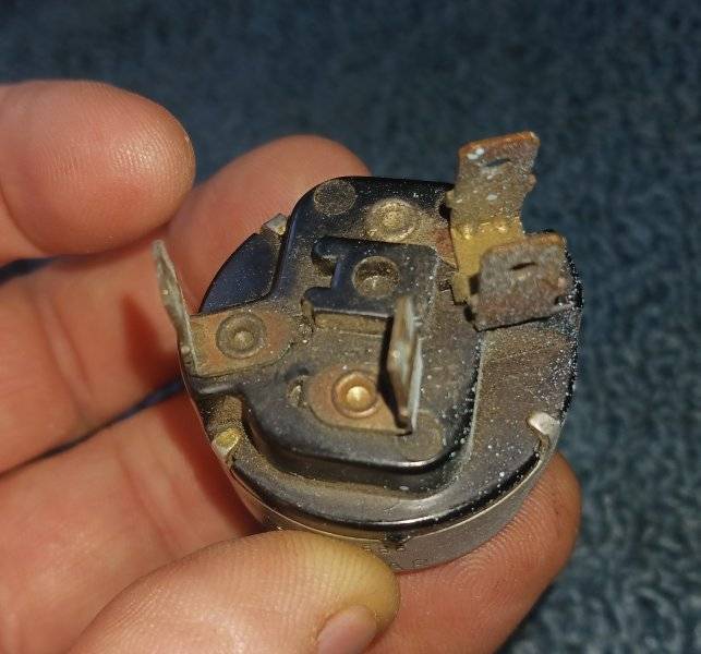

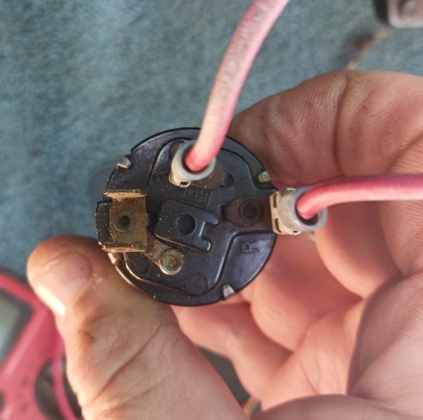

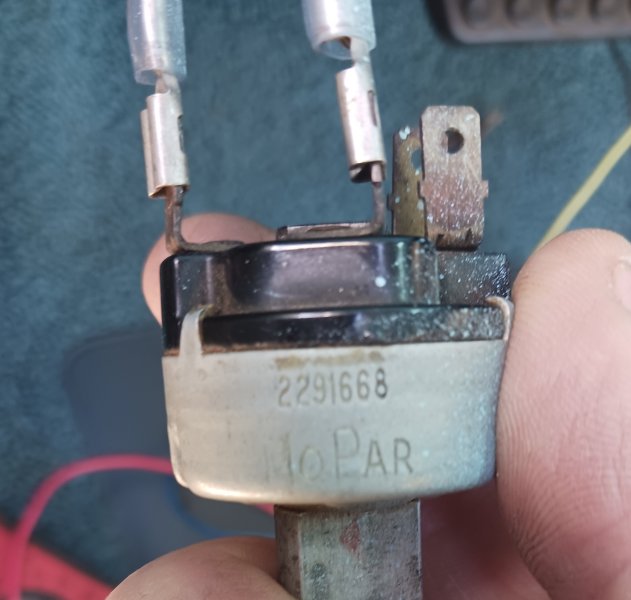

It looks like I have the wrong wiper switch. The harness plug doesnt fit the switch, there are a couple jumper wires connecting it. The switch thats in there now is mopar part # 2291668, which appears to be a switch for a 63-64. Looking online I cannot find a switch that matches the plug. The car also has a washer and from what I have read, the washer is activated by pushing the switch in, and this switch I have doesnt have that option. Any thoughts? see pics
Yes, that switch does not belong in a 65 Belvedere, at least with a variable speed motor. I purchased a NOS from a vendor-don't recall which one though.

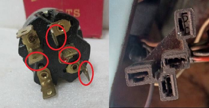

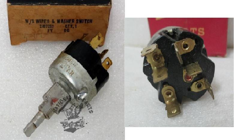

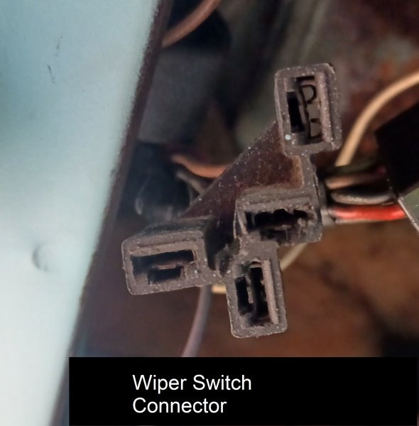

I think i found the correct one. Part # 2497282. Does the harness connector look right for this switch?
