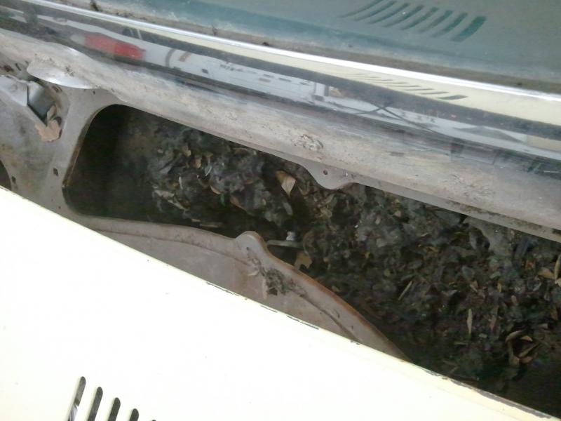

Took off my cowl screens and found this, my wiper trans was lying underneath this mess. Will I need just the bushings to connect or are there more pieces that are required? rat nest.jpg
I think besides the bushing you will need the round clip that goes over it and holds the bushing in place.

Ya get that drain at the bottom all clean and clear.
