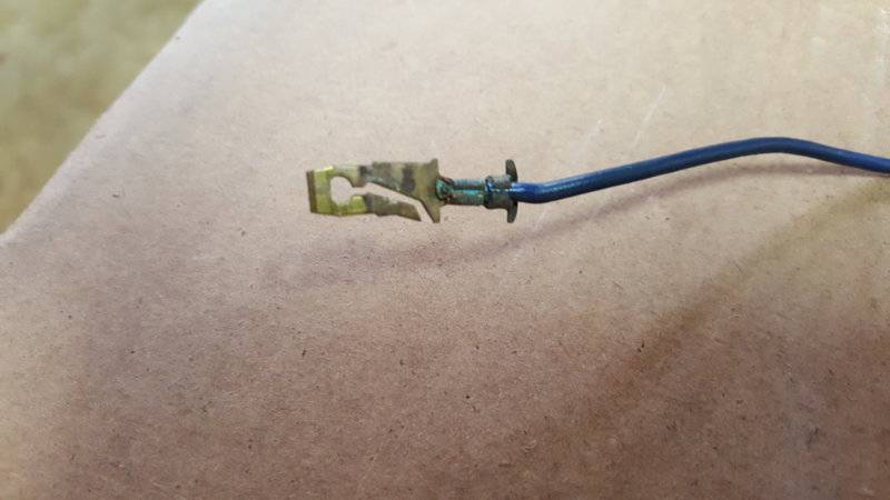

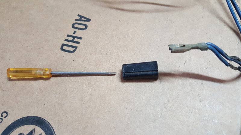

I have a wire coming out of the ignition plug that looks a bit sketchy. I assume once you pull the plug off that there is a tang or something that holds the wire in the plug. Assuming I need to replace the wire can you get the piece off that holds the wire in to reuse it on a new wire? TIA Burt

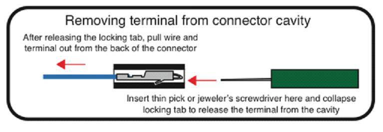

Take a packing staple or other thin narrow piece of metal and insert it from the female end of the plug, next to the terminal you want to remove. There is a small tang on the terminal that prevents it from being removed. Use the metal to 'flatten' that tang and the wire/terminal will pull out the rear of the plug.
You may be able to reuse the terminal, but it's a hassle. Go to NAPA and buy a new matching one.
