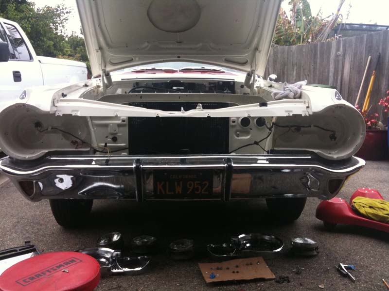

I have a 1964 polara and want to know if the engine bay harness for 1964 and 1965 are interchangable please. Thanks.
Go to year one see if they list different numbers for a 65 coronet as alot of parts for the 64 polara and 65 coronet are the same they will probably be very close.65 polara is a c body
There are two wiring harnesses - an engine harness and a headlight harness. The engine harness is interchangable.
I bought a 65 Coronet headlight harness for my 64 Dodge and it seems to be a little different. It does plug into the firewall bulhead and work just fine.
The differences that I saw were that the wiring that spans the distance between the headlights it a little shorter- not by a lot but maybe a few inches. Then the plugs that go to the park/ turn signals has a different plug - males instead of females to mate up with your park / turn signals (park / turn has a male connector).
I lengthened the short-ish wires and modified the park connectors and all is fine. If you're looking to plug in and go, find a 64 Dodge harness.
