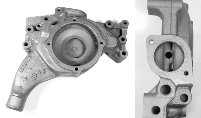

I think you two are confused.
There are 3 ports of the right size, 2 are the heater hose ports the other is plugged 'thats where he needs to install the autometer sensor'... below those sits the smaller original temp sensor port.

I was thinking more of something along these lines so you could try to keep the stock appearance, measure the hole distance and compare you might find one of these applications works for you.

Pretty fancy, Big Man. I might just use one of those to get my OEM gauge working one of these days (while keeping my autometer).
That meziere one is exactly what i want. Gotta find somebody at work tmrw with an ebay account
Yep that one is the only one I know of that will work on the RB big blocks, **** now I want one for myself lmao!
