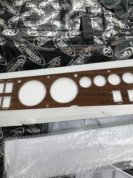

Do I Need To Remove The Old Bezel?
Yes. The woodgrain is held to the plastic chrome bacher with small tabs. Straighten out the tabs and the woodgrain pops right off. Install is the opposite.
Be very careful with those tabs on the back...you only get one or two goes at those. :eek:
does your new wood grain panel have the little fold over tabs on the back of it? it may not.
there is a bare metal plate with those fold over tabs, then the wood grain panel glues to that bare metal panel.
