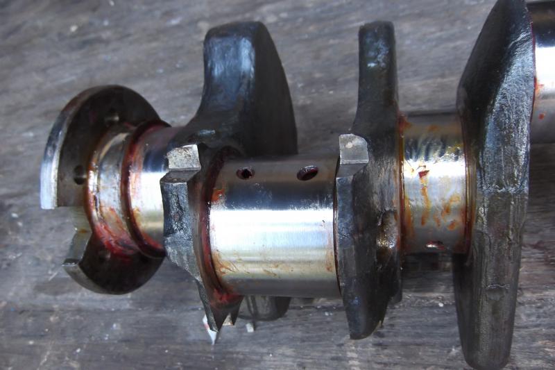

Look down on lower lobe seems to be little scrape of metal off one of the lobes?thats cosmoline on journals. 3Kc3Gb3L65N35F65Jcd4dc858964dbf3617cb.jpg
Can't really see any thing in the pic. If you can feel it with your finger nail ? I would say either try and polish the journal if that won't work have the crank turned!
all you have to do is ask for better pics.and i'll send them to ya.thanks,kent

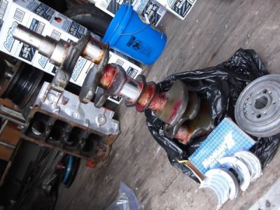

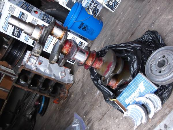

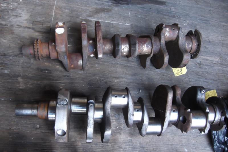

i was cleaning the crank when it dawned on me what he is talking about.he's referring to the cuts in the counterbalance.most have them.i'll send you some pics.johnny.thanks
440 cranks
the 2 in the last pic also have cuts in them as most do.thanks,kent
