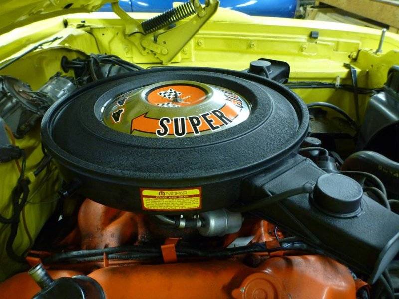

I have my doubts that is factory finish... this one on my Bird has never been repainted. I've heard that VHT wrinkle finish, sprayed from extra distance works well.

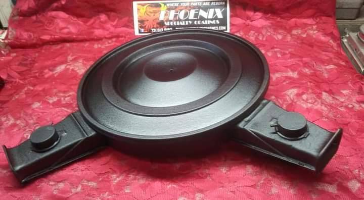

There was a member here who could help if you need a pie tin for it... :lol:

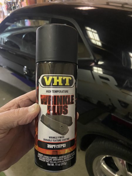

I used the VHT from a distance and baked under heat lamps after sprayed on my valve covers. Wrinkled perfectly. Hard to tell, but I guess I have never taken close up photos.

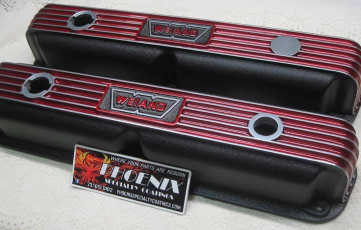

Feedback from the Technical Director of the International Chrysler Collectors' Association about my wrinkle and HP273 Commando valve covers:
He took his 1965 Dart Charger to the MCACN a few years ago. It scored 996 out of a possible 1000 and my valve covers were not included in any of the deductions.
Neener neener :poke:
