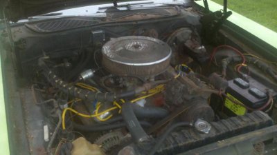

The two cap pictured were my options when I ordered the caps from AdvanceAuto. The thinner one is the one I went with as it fit tighter and it was listed as "April and Older" while the thicker one was listed as "May and Newer". Now the second one looks more like the one that was on the car many many years ago, but it did not fit well at all. Hence the reason I went with the thinner one. I also did put a new tank on it last year. The new tank looked identical to the old one and had the four fittings coming out of the driver side of the tank. I put them in the same locations as they came off. After reading your other response, I've always wondered what the "tube to nowhere" was in the engine bay of my car. Seems it may have something to do with an evaporative emmissions system. I attache a pic of the car as it came out of storage. If you look at the left side of the engine bay, just above the A/C line drier (next to the coil), there is a line coming from the drier that makes a left and then heads to the rear of the car before diving down befind the fender well. Just before it makes that dive you can see the mystery, open ended tube to nowhere. Been like that for the 26 years I've had this car.
Judging by the aftermarket valve covers and air cleaner, I'm guessing the breather is incorrect (or missing; can't see because its location is hidden by the fuel filter and heater hoses) I'd say the "mystery" is down to someone having hacked away at a system they did not understand.
Your carburetor has a bowl vent fitting, 11/32" diameter, near the top front. There should be a hose running from it to the crankcase breather. It looks as if there is not. What is that fitting ducted to, if anything? Is it capped?

On the right side of the engine behind the A/C compressor there is a breather cap on the valve cover. The PCV is on the left valve cover, which is obscured by the fuel filter. You can just make out the PCV hose running across the valve cover before it heads to the base of the carburator. The carb in the picture is a Carter AFB. It has since been replaced with a Edlebrock 1406 which is essentially the same carb. As far as the hacked system goes, what you are seeing in the pic is the way I got the car in 1985. That tube by the drier has always been like that. I was never concerned with what it was as the car always ran great. Since I replaced the tank and everthing else, I must've upset the balance of the force or something...

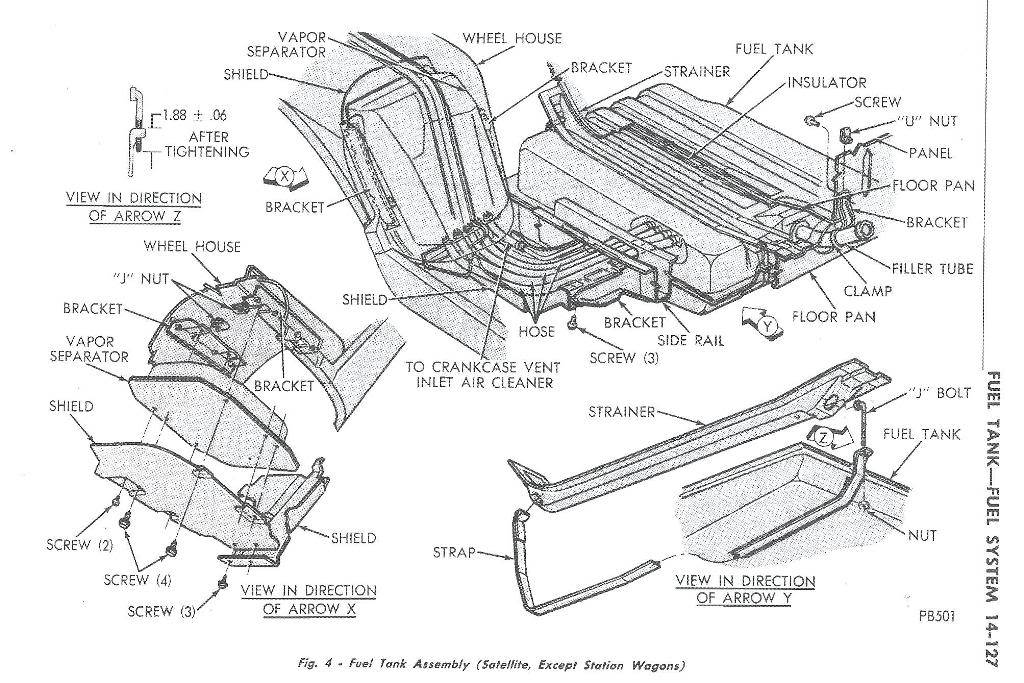

Here is the 72' version, shows the charcoal canister, the tank vent system depiction is not acurate but basic tank layout is the same for 71'. The four tank vent nipples are on the driver’s side of the 71-throuth April 72’ tank with a lager vapor separator in the left rear wheel well. May 72’ and up these nipples are at the upper front of the tank with a much smaller separator mounted above the diff.

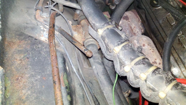

So the mystery tube in my pic isbody the tank vent that is supposed to be hooked up to the crank case breather somehow? If this line is plugged, it can possibly give me the hot start/run issues I'm having? My tank vent manifold setup is not near as nice as that pic. The four hoses run to the manifold then disappear into the body. Can I blow air through th lines to see if th there are any blockages?
In the '71 system as originally set up, the fuel tank's one and only vent line (coming off the 5-port cylinder in the trunk) and the carburetor bowl are both vented to the engine crankcase via two small fittings on the crankcase breather. You no longer have a factory-type breather, which means those two fittings are absent, which means the fuel tank and carb bowl are vented to ????? or their vents are blocked off. Still waiting to learn about your carb bowl vent as asked in post #7 of this thread.

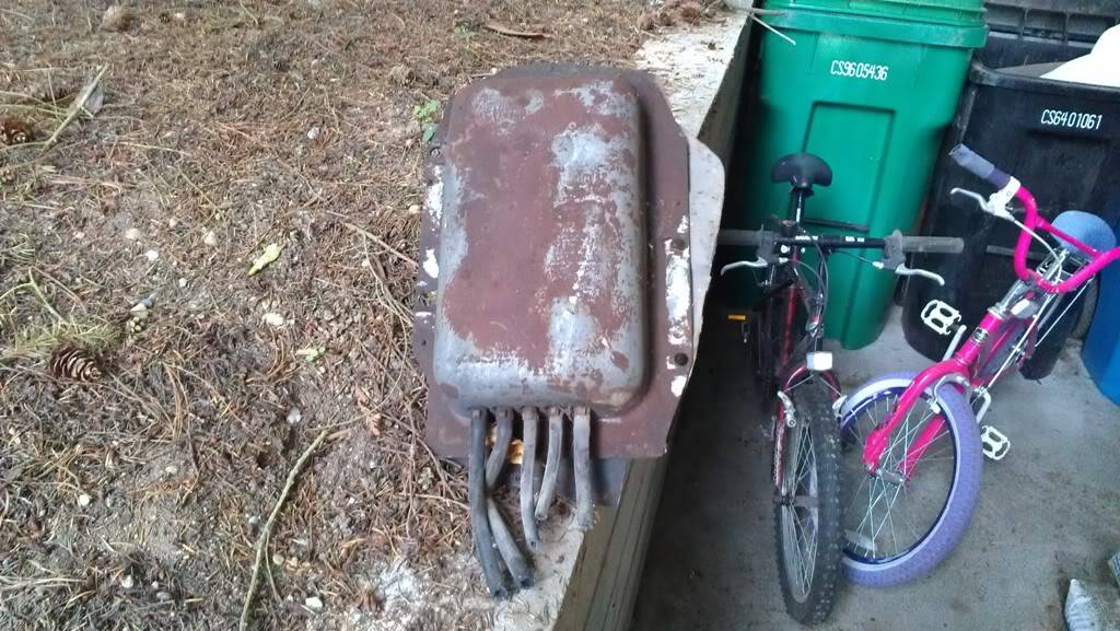

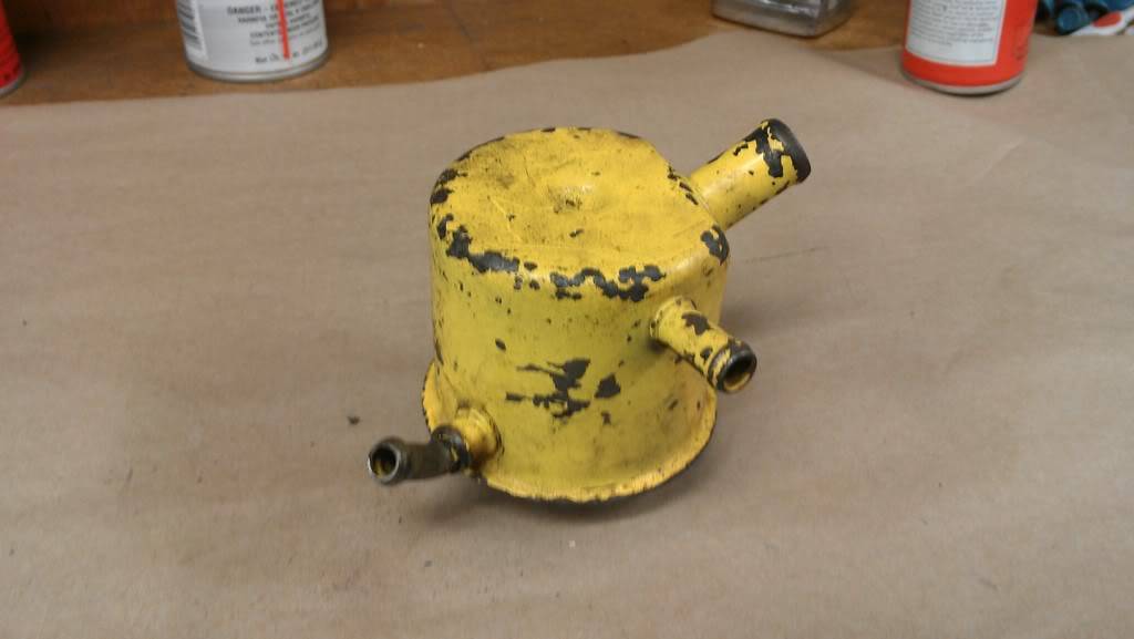

The 71’ b-body fuel tank vapor separator.

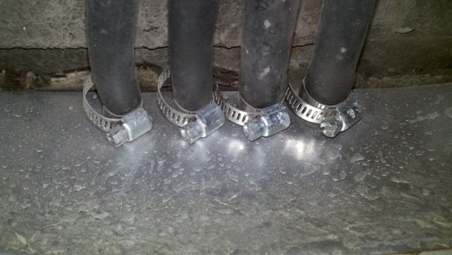

Mounted in the rear of the left rear wheel well, the hoses exit the tank and pass through the frame rail to the nipples at the bottom of the separator, a metal shield covers the hoses outboard of the frame rail. The fifth connection (at the far right in the picture) connects to the hard line running to the engine compartment. As long as the other end of line is not closed off to atmospheric pressure, I’m not following how the tank vent system could create a hard starting condition and a high speed “fall off”. I understand that you are running an aftermarket carb, may not have the enclosed bowl vent valve fitting. Without an original style breather cap with the correct 71’ hose nipple configuration (3 of them) you won’t have anywhere to connect these lines short of rounding up some 72’ charcoal canister parts as mentioned.
71' system

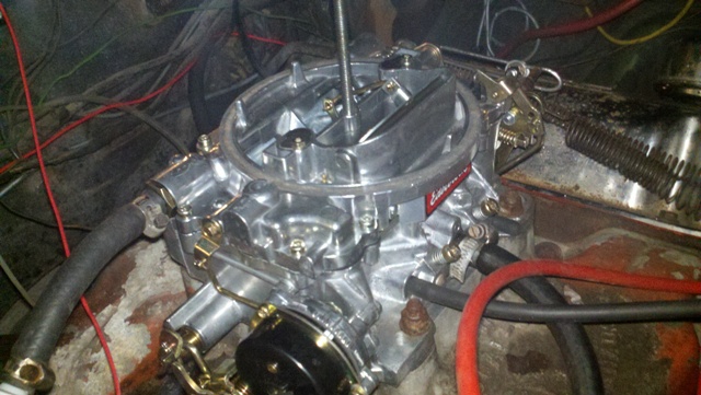

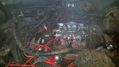

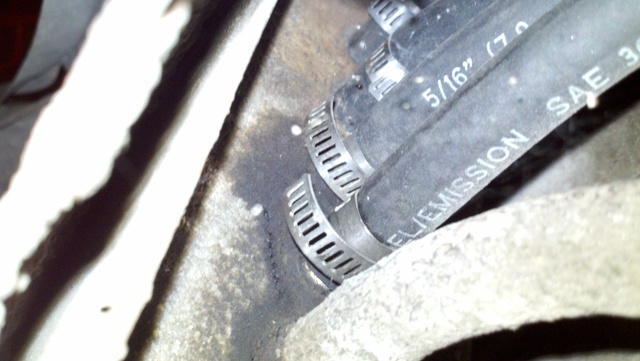

Here are some pictures I took of the various systems. Please dont hate on the wiring. The car sat for 19 years. I'm still cleaning it up. Once I know its running consistent, I'll route/hide wires. Dont forget to checkout the knarly kickdown bracket.

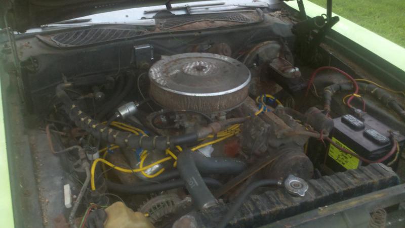

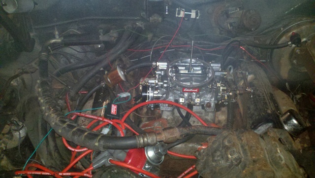

Engine Bay. FrankenRunner

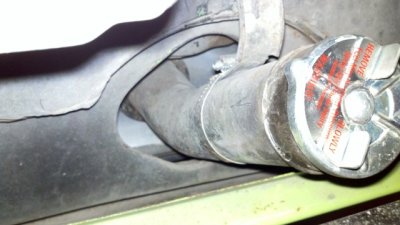

Filler Neck

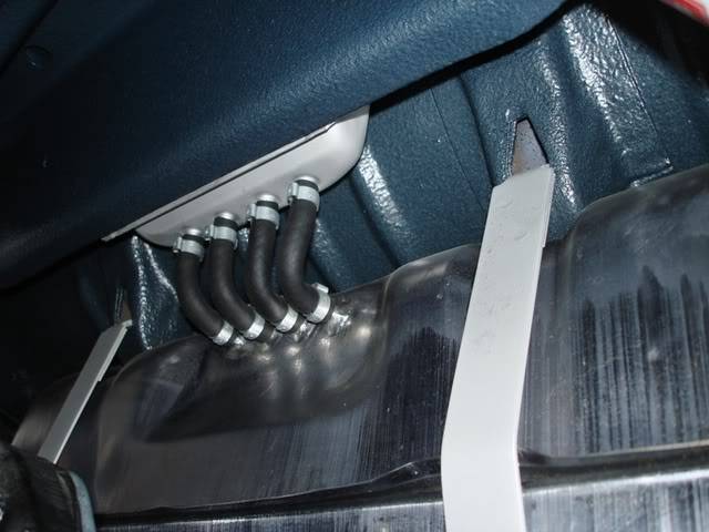

Tank Vent Lines

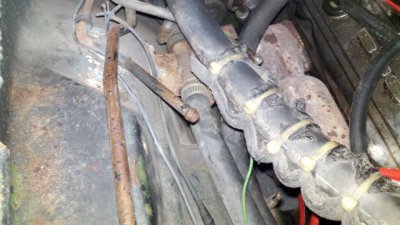

Mystery Tube Engine Bay. Tank Vent I'm guessing.
Separator Inlets

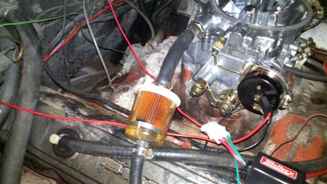

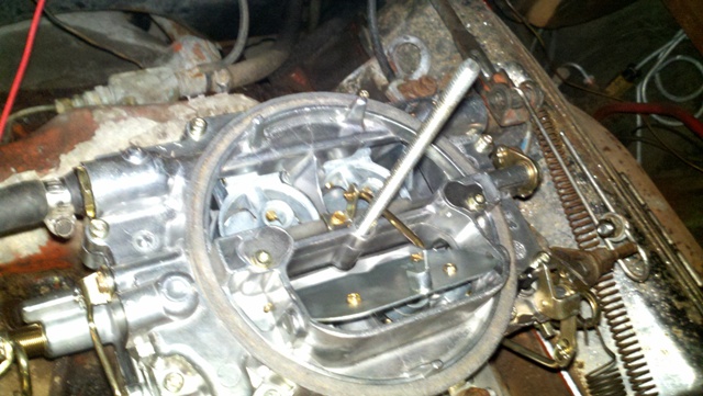

Carb Edlebrock 1406 (Same as the Carter AFB)
Carb Side
Carb Top
If I get off at a decent time today, I'll run a coat hanger down the vent tube in the engine bay. Could be a dead critter in there.
These pictures show that your aftermarket carb is not equipped with a bowl vent valve and fitting. The tube questioned is the vent line from the tank separator and it appears to be open to atmospheric pressure. I would also suggest that you re-route that fuel pump to carb line away from the exhaust manifold, appears to hang directly over it. That would tend to pre-heat the fuel before reaching the carb contributing to a possible heat soak percolation problem. Factory hard line routing had it running up the front of the motor around the distributor to avoid manifold heat.
Looking at the engine bay picture, I should run the fuel line up the front and between the distributor and A/C compressor?
I believe the carb bowl vents are those two cresent shaped pockets right next to the air cleaner flange, so they would be vented directly back into the carb via the barrels. Since my car is FAAAAAR from a numbers matching Satellite or Roadrunner, I dont know that I will worry too much right now about a correct carb.
With my tank venting to atmosphere, I can possibly assume that there may be a blockage in that line somewhere? If I have to, I can run the PCV on the other valve cover and get a new crank vent breather with a couple of nipples and run the tank vent to one nipple and the other to, I dont know, the vacuum line right above the right bank air/fuel mixture screw? Thats the only other open vacuum line I have left on the carb.
