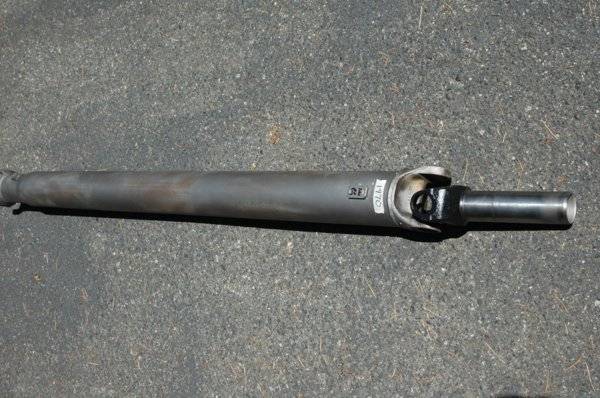

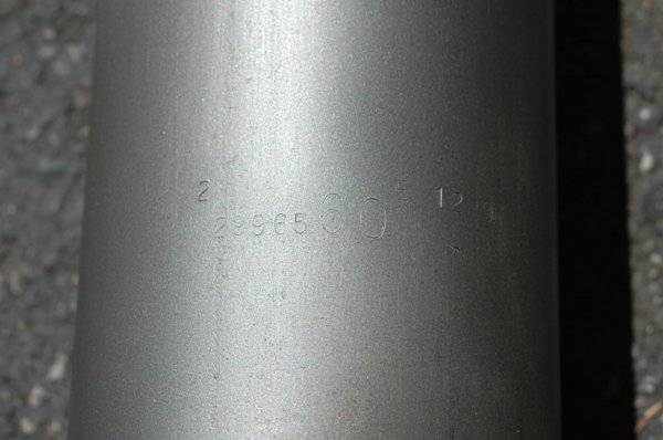

This is the one you need 2996560
Can't tell, should be 50.39 inches center to center of u joints, 7290 u joints front and back, and internal vibration damper, 3.25 diameter.
Allot or shafts are close and will work but if you want th correct one you need to see the numbers on it.
