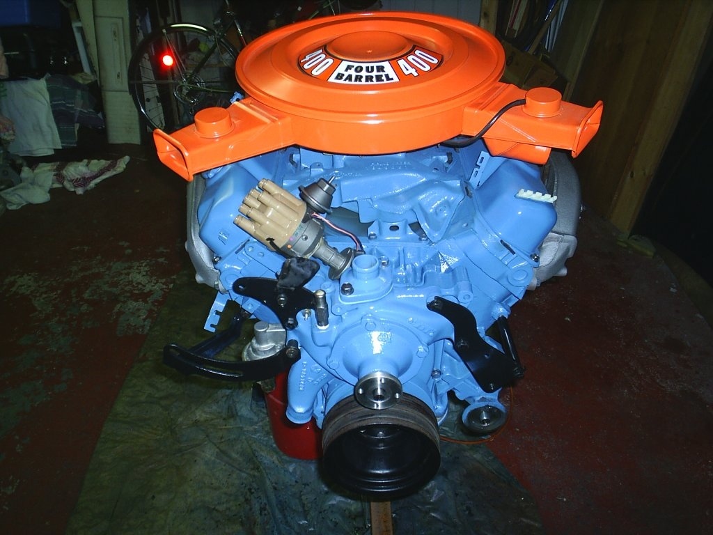

Here is a shot of the front of my 73 as it was being all put back together. Not sure if the numbers are the same (intake is not) but you may be able to zoom and see.
As far as the radiator it depends on what the rad support will take. Mine has a 28. But overall anything with in/out matching will work I would think.
