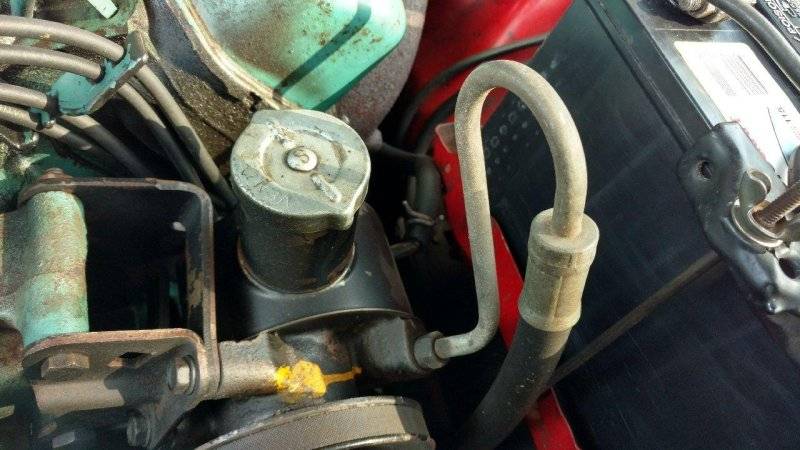

I am wondering if original power steering pump on 1968 Dodge Charger R/T 440 engine is Federal or TRW brand manufacture? Bob Horman
Richard cranium has a survivor 68 440 rt...if he can chime in ?
3white74 what does you post to me mean? do you want me to contact Richard Cranium for an answer to my question? Bob Horman
I have my original on my 68 and its TRW
Yes. Robert horman his car is survivor all original OEM stuff the whole car and engine. I believe 68 RT is right too. It is the TRW. I think much smaller pump than the federal
paging a member is as easy as @Richard Cranium
As requested by my #1 fan ......
Ditto on TRW for my ‘68 bee. I’ve used the Saginaw off a 69 charger while the original was being rebuilt. The Saginaw worked much better.
