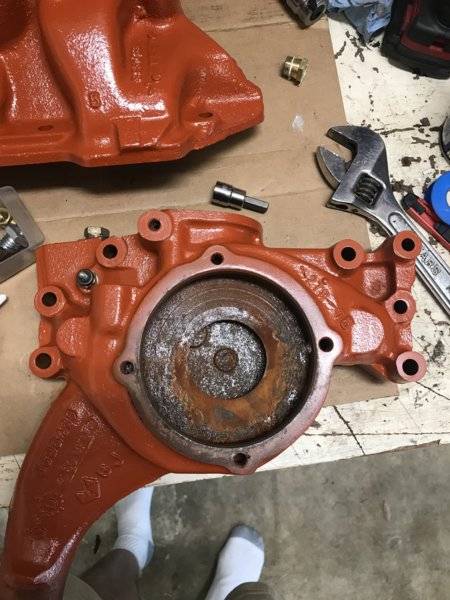

There are 2 extra plugs on the top of my water pump housing next to the heater hose nipples. I assume this a good place for the temp gauge?

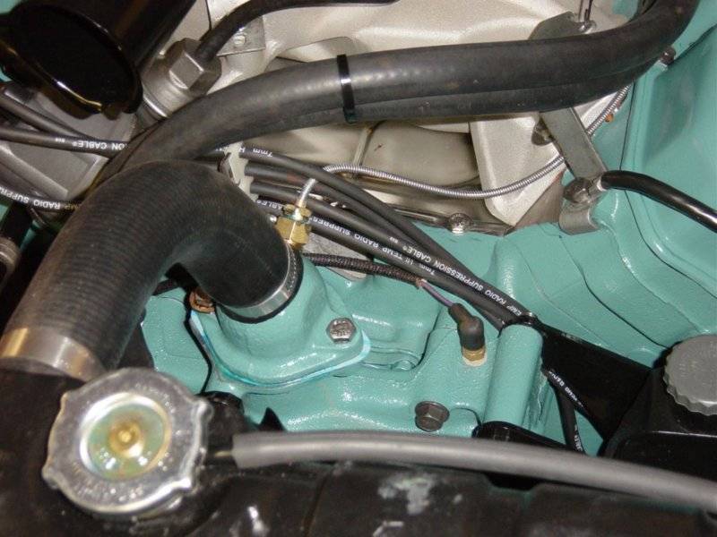

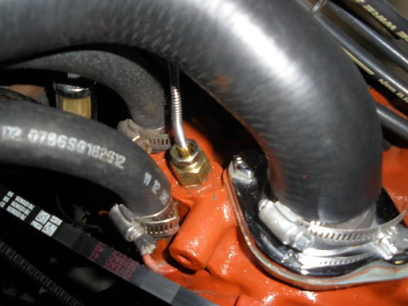

There are two places you can put it...mine is on the driver side like the blue engine here. I don't think it matters operation-wise, since either location puts the sender in the return flow right before the T-stat
View attachment 664437 View attachment 664438
I have the lower passenger side inlet housing so I put the mopar sender on the front and will add my aftermarket sender to the top.
