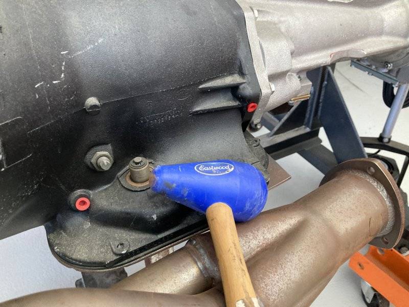

Like AndyF pointed out, you have many changes going on that the header company can't be responsible for. If you can do it, I would recommend putting the engine on a stand, bolt the QA on, bolt the p/s box on, bolt the headers on and work out where you may need tube denting. These kind of changes you have going on are the very reason I ordered my TTI's uncoated. In my 65, I'm using a 70 k-frame, Borgeson box, Indy low deck aluminum wedge with Schumacher conversion mounts[ hemi style block, wedge k-frame]. Even though my headers are specific to that engine, I know from experience it's a rare day when an aftermarket part truly fits. The pipes needed to be worked on a couple of the cross bolt main fasteners, engine mounts, starter[ it was the recommended one from TTI], k-frame. Had to chamfer down the head flange on the lower edge to clear the head studs. A plastic mallet like this will help to lessen any coating damage on the pipe. Especially if you hit the mallet with a dead blow hammer.
