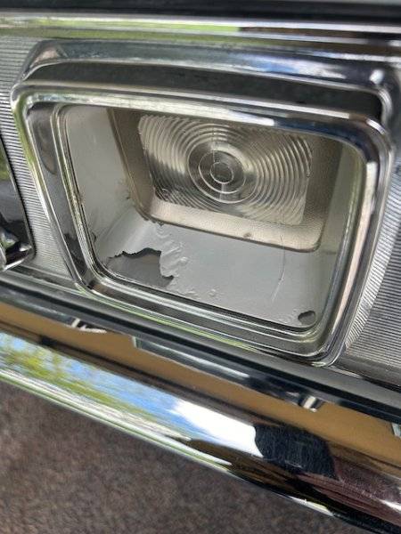

Hola fellow Travelers...... not a big thing but wondering what is the best fix here......... DIY or do they make aftermarket...... brake lights are good and reverse lights work... just looks a bit shoddy.....

You can try removing what's peeling off and spray paint a metallic silver for a temporary fix. Just peel it off with your fingers and don't scratch it. It might not all come off but just get what's loose. Spray dry coats as not to cause a reaction with what's on there. One dry coat might be enough.
I did it with my '62s front turn signal lenses that were peeling on the backside like yours.
My car has the exact same thing. I found another nice one. But since I didn't want to open up tailight surgery, it's sitting on the bench :lol: :rolleyes:
I build model car kits, so can offer advice on refinishing plastic without destroying it. I also have a 1964 Polara. The old silver paint can be removed with Castrol Super Clean without marring the clear plastic. You can respray the back of the lens with model car silver or chrome paint. Some cleaners or paints not meant for plastic can craze it.

Normally to paint on plastic you remove the old finish. Then clean with a good grease and wax remover / surface prep.
Dust with a adhesion promoter
( Bull dog ) ect. Then put a coat of epoxy primer/sealer with a little extra reducer in it. Then paint.
Or....... for a small area like that go to a hobby store and grab one of those 1/4 size rattle can of Testers model car paint.
It is made to lay right on plastic and not craze. :lol:

All that prep and stuff won't work here. What you are looking at is the back side of the applied paint through a clear lens. The paint is sprayed on the back of the lens, not the front surface.

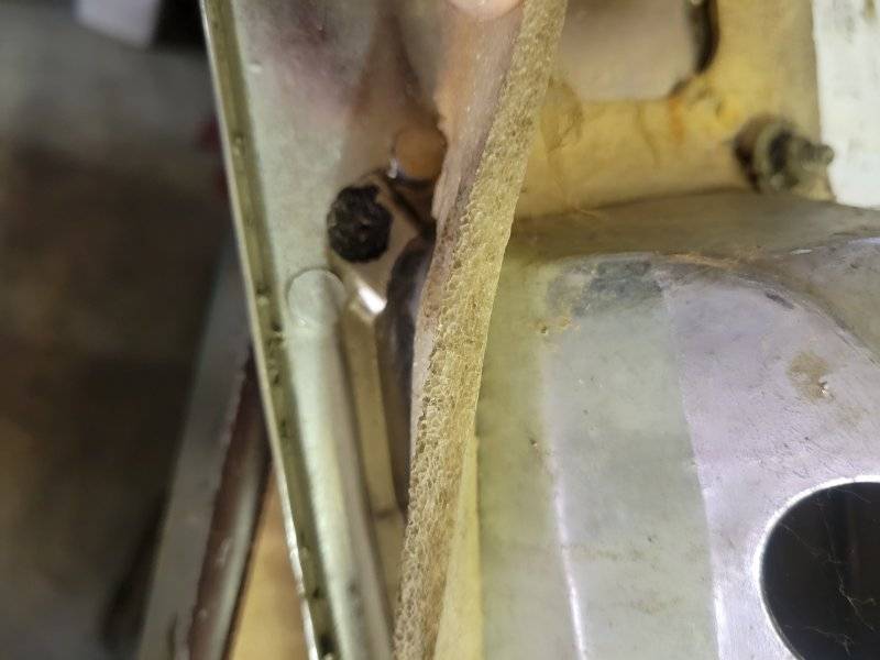

Not that easy as some are Phillips head behind the gasket...
