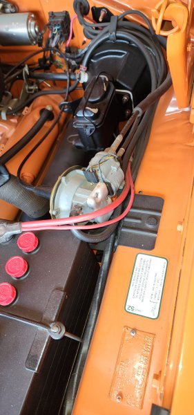

It could be a problem acquiring all the parts for an original setup. My Superbird was bought from the original owner. He bought the car new in 71 and had cruise control added. In restoration I decided to keep the cruise control and it still works great today.
