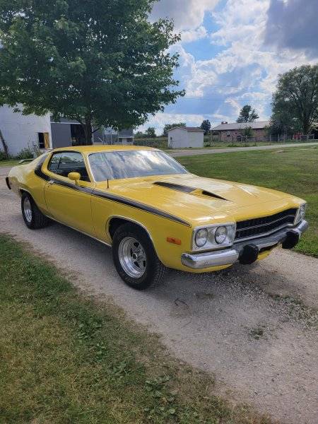

I have a 1973 Roadrunner that I'm putting a 408 in. It has manual steering and I need to convert it to power steering. Looking for advice on what pump to buy and what I all have to do to make this work.
