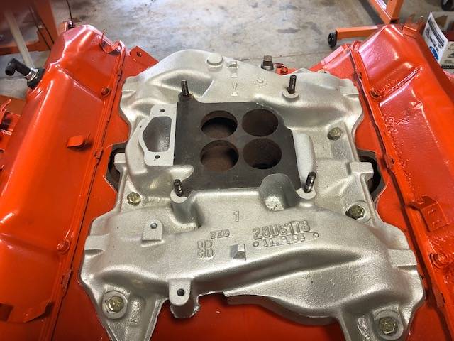

Guys, Mopar nube here and just finishing up my first bb. Need a carb, my intake was cast in 1966 and is a square flange....so , my spread bore TQs won't work. I think an Edlebrock carb will bolt on with no spacer required.....but not sure if there is a better choice. Will a square bore Holley fit? I m thinking a 750cfm would be whats needed? thanks.....

You need to post the intake casting number before taking any advice
This is the stock intake, if I get it to upload, that I am planning to use. I found a brand new , in the box , Eldlebrock carb, that I purchased for another project years ago that has never been installed. The script says its a 750 cfm, manual choke and #9907. How does that compare to a 1407? I have piddled mostly with Holleys and Quadrajets but never any Eldlebrocks. I don t see much gain in the purchase of a new performance intake if using cast exhaust manifolds ...is that a fair assumption? In watching Nick of Nicks Garage dyno his 440 for his Kowallsky car , he made 400 hp thru a 70 stock intake and cast manifolds. But of course i m not sure of his cam and head choice. Think he was running a 780 double pumper also...

Good. Its a "178" intake, used on 1967 through 1969 440 HPs. Just confirming.
Yes a Holley will fit.
Pick a any large - square bore carb (i.e. 1.75" primary and secondary throttle bores) of your liking in the 750 to 850 range. Holley, Edelbrock or Carter AFB/AVS.
