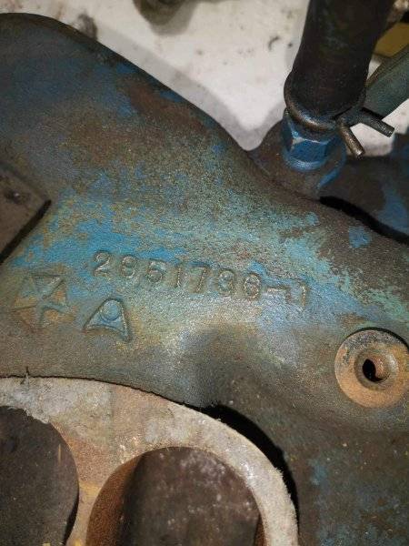

Hey all, found an old one locally I might grab. Looks like a 70’s manifold so it sounds like it’ll work for the Holley carb.
Can anyone confirm?
2951736 is a 1970 440 intake. A holley will bolt on, but you might need a thick gasket for accelerator pump clearance, and a throttle arm adapter for mopar linkage.
That’s great - I’ll probably grab it then. Thanks for the note.
