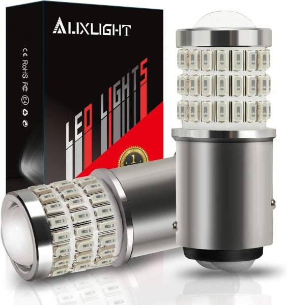

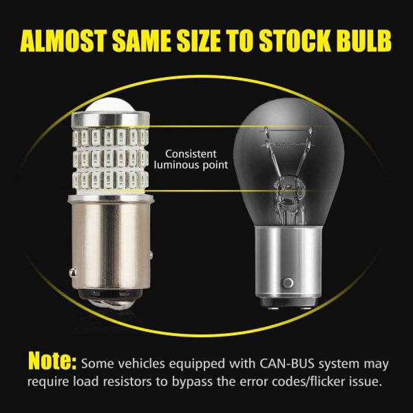

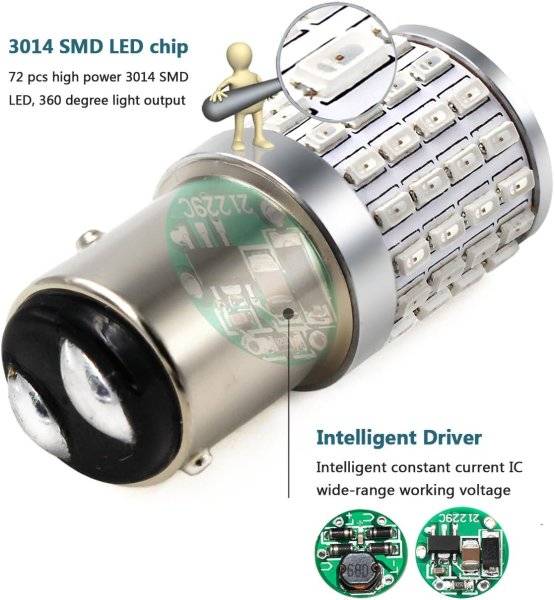

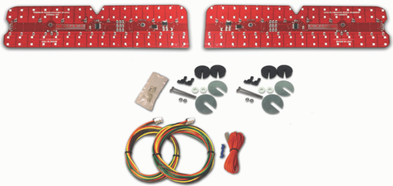

The metal taillite housing for a 70RR has a smaller diameter opening for the bulb mounting and certain LED 1157 replacements are too large to fit through the smaller opening. Check around and U will find various diameter size 1157 replacement. Attached are (2) images as examples of the bigger diameter. Now check image 3, U will see its slimmer size. Also as a final option, Digi Tails has a clever, custome OE PCB module(w/sequential option) with strings of LEDs mounted it is more expensive but has greater briteness.

Interesting, your first example appears to be a Speedway Motors branded 1157 replacement, showing a spec’d 1” diameter. If that’s the case shouldn’t have any problem fitting one through your ’70 socket hole. The individual LED orientation on that bulb would not be recommended for a parabolic reflector housing as is the taillight housing in question here, wouldn’t consider that one as an 1157 replacement anyway. Example #2 looks to be smaller than the Speedway Motors led.
If a LED 1157 replacement can’t fit where the 1157 incandescent fits, it’s not really a 1157 replacement.

For that Speedway Motors branded bulb (example 1 above), while the PCB may likely fit into hole in the housing, I see now that the location of the PCB, so close to the bulb base, could cause it to interfere with the socket clips, preventing the socket from being able to snap in to place. That one I would rule out as a true 1157 replacement on that issue only.

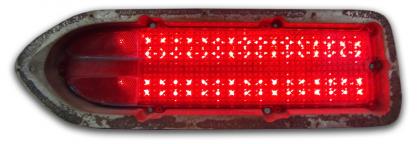

Regarding the LED string module supplied by DigiTails, I actually have this part. The modules are designed to drop into the factory tail light. To connect to the OE wiring harness, they provide output wire leads and male bulb socket bases are available so the entire assembly plugs into the OE wiring harness. I attached a picture of the LED modules....
Just my $0.02... :thumbsup:

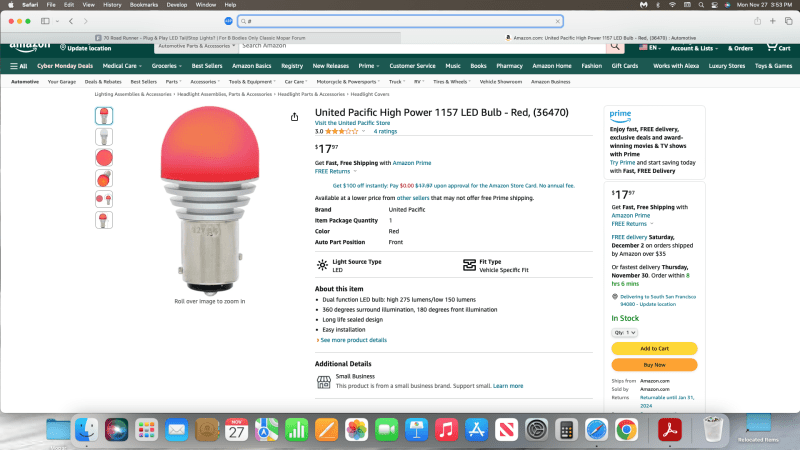

OK. Here are the LEDs I found that work great for my 70RR and slip right into the factory housing. They are sold in pairs by Amazon for about $14.00 From the picture U can see how slim they are and can be direct replacement for the standard 1157 bulb.

Not only the weatherproof aspect but the way we need to push and twist the bulb to get it in the socket, I wouldn’t want to put that stress directly on the LED’s that are soldered to the circuit boards in the bulbs - you might break the solder joints or rip some LED’s off. I want a cover or something to grip on, other than the LED’s

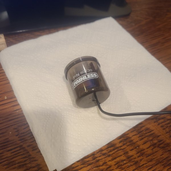

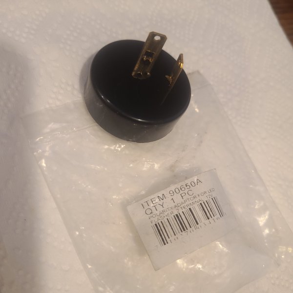

Just replaced the running lights, brake lights and turn signals with leds on my 71 road runner. I recommend the use of red leds where the housing lens is red and orange leds on for the orange housings. For the turn signals upgrade to a digital timer, the lights will flash consistently and won't slow or stop at low rpms. You will need 2 flashers 1 for turn signals and 1 for the hazards. see attached:
My road runner required this adapter to change polarity on the timer but my barracuda did not.
