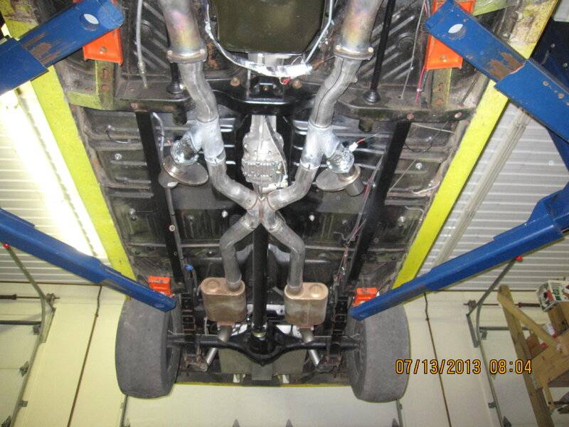

I run the 2 chamber 3", dumping in front of the axle. It doesn't bother me (going deaf anyway) but my wagon has no interior behind the buckets. It does get pretty loud when I open the cutouts though!
Mike
That exhaust is almost identical to mine.
3" from headers to tailpipe tip, but mine exit the rear under the bumper. The Doug's "guillotine style" electronic cutouts are the best design. That X pipe even looks like the prefab one I have, and the Flowmasters too.
Sounds great, open or closed!
I built the entire system from scratch. Straight pipe and 180* u-bends.
