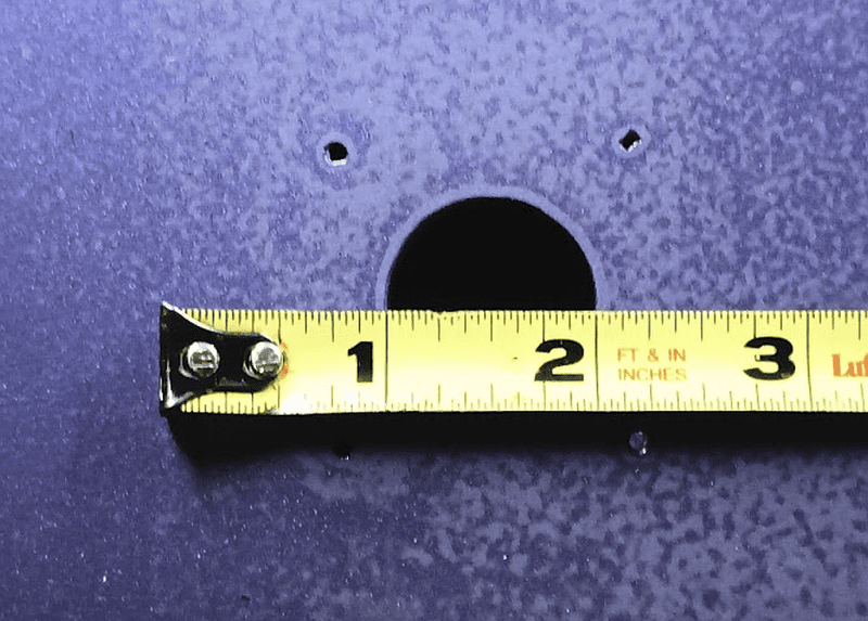

Hello, What size are the holes that are drilled in the hood where the hood pins go through? Also, what size are the holes for the screws for the plate that screw to the hood? Thanks!

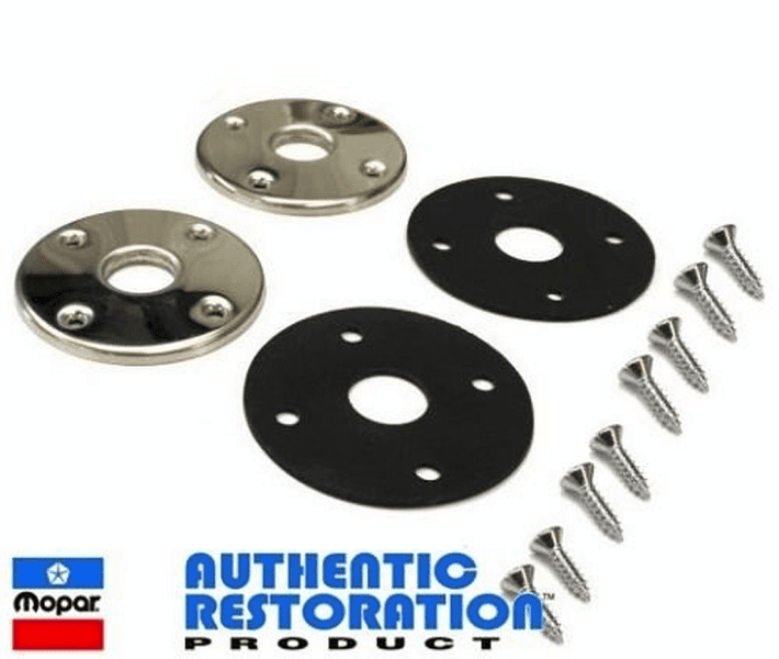

I have a 71 Cuda and hopefully B are the same size. I have an AMD repro hood and the pin holes are a shade under 1", the Pin itself is a 1/2", gives some room to fit, and the screw holes are maybe 7/32", but they are self tapping. I think AMD is metric with the opening because of it less than 1". Your best bet is to buy the set and use it for a template. The opening on the chrome plate is 3/4". check to make sure E & B body hood pins are the same.

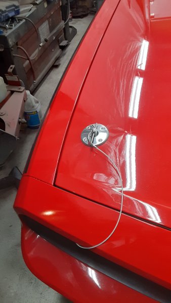

I bought a billet pin holder because I didn't like the look of a flat chrome plate,
Flat plates are after market items. The factory plate is stamped and raised off the hood except for the edges. My factory plates look like these reproductions.

I put a set of factory style hood pins on my 2010 Challenger. I drilled the holes to 7/8ths . I knew that the factory holes were larger the 3/4 but I thought that they were less than an inch. An inch appears to be correct though.
