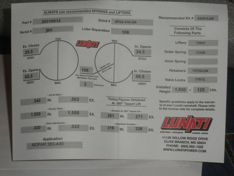

I am far from an expert but this is the cam I have in my 440-495 at 9.8 to 1:
This cam is smaller than yours, I have less cubes than you but almost 2 points more compression.
Mine runs fine but sure was more snappy below 4000 with a smaller cam.
Wouldn't you have to spin yours to the moon to take advantage of that cam?
My cam was in my 470. It ran to 7000 no problem.
