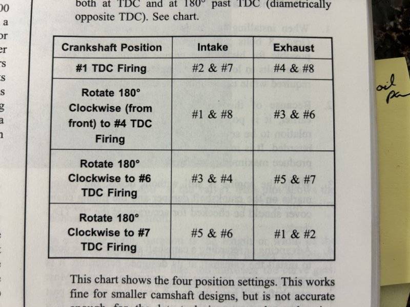

You have a Mopar cam in a Mopar engine. I've got a crazy idea. Why not pull out your Mopar Performance Parts, Big Block "B-RB Engines book and look it up. I know that sounds far out, but I'm a weirdo. It happens everyday. People work on a Mopar engine without reading the appropriate engine book. I've never understood that. I even have friends that do it. Anyway, turn to page 151...and if you're wondering the sequence to adjust the valves...the Mopar way is the easiest. All that crap I hear on the internet about bumping the starter 500 times...when this valve moves adjust this one, blah, blah, blah.
^^THIS^^
