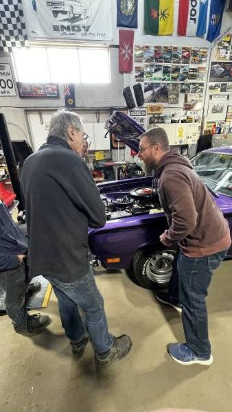

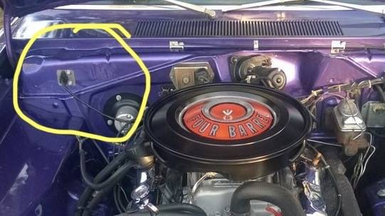

While under the hood, Nick and his guys were stumped by a component they saw on my firewall.
"What's that?", Nick asked as he pointed to it.
Could it be I knew something about my Mopar that Nick didn't?
I explained it was a Los Angeles built car and then it clicked to him.

Don't keep us in suspense, what is it?
Manny and Niko offering Nick moral support as always. His flag collection is amazing!
That thing has baffled many a Mopar folks after I took possession of the car. It's an NOX solenoid/valve. I have also heard it called an OSAC valve. It's an early emissions device on the California cars.
