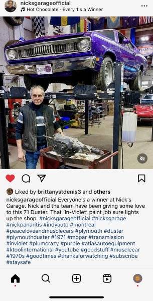

And then yesterday morning, my daughter told me another post was made with the car in the air, transmission removed.
She said "Daddy, your transmission is out and on the surgeon's table" :lol:
So after I saw the transmission was removed, I reached out to Nick for an update.
He responded with a picture and a couple of short videos of what he discovered upon initial observation.
After seeing the pics and video, I appreciated even more that I'm having the transmission worked on now instead of waiting to make it a retirement project in a few years.
Drastic play in the shift levers as you can see here.
Bearings….this video says it all.
And that input shaft looks like someone’s been rubbing it the wrong way LOL…

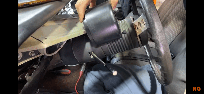

If you’ll notice in the video, Nick pointed out that the steering wheel and the column cover are from an E-body. And also that the steering wheel was upside down!
I had no clue that any of that was the case.
He offered to make both of those correct. I declined as that is something I can get to at some point myself, if it becomes a sticking point to me.
He did say he’d put the steering wheel back on in the correct orientation however.
