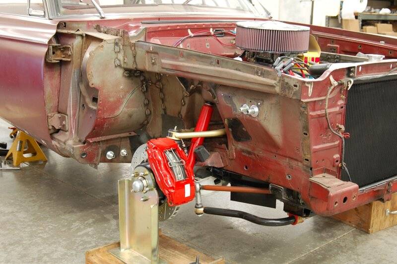

This is what I recommend. 13 inch brakes, big tubular anti-sway bar, Koni shocks, Firm Feel upper arms, boxed lower arms and then play with the torsion bars until you get the right "feel". This combination will feel like a new sporty car when you drive it. Not a Porsche, but a new sporty car like a Charger GT or something like that.

Andyf, Thanks so much for this input . My car is OE torsion bars, and front sway, no rear sway, KYB shocks, 11.75 front brakes with wilwood 4 piston calipers. It stops what I feel is very good. (11” rear drums). I truly appreciate the advice. What size front bar do you think I should start with ? Thanks again !
I wouldn't change the torsion bars. Put a big anti-sway bar on there and buy good shocks. Koni or Bilstein. For sway bar look at Firm Feel, Helwig or Hotchkis. I'd recommend a 1.25 diameter tubular bar.
