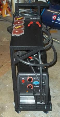

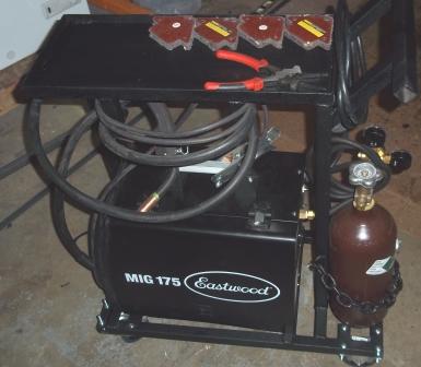

I bought an Eastwood MIG 175 and so far love it, built the welding cart you see with it...best part was for $580 shipped you get the welder, its standard attachments and a spool gun for welding aluminum (which I havent tried yet) but that usually costs $200 on its own. And so far it works just as good as a lincoln electric which I have used.
