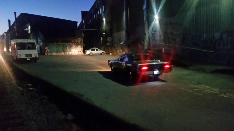

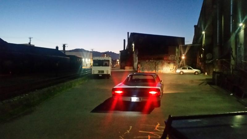

purchased everything on ebay. 4 Amber lights for front signals were around 20$ with shipping. flasher 11$. Checked some of the usual parts stores some have the lights but not the flasher. One local store said they could order the flasher at 25$
Link and pictures? I put white led's in the rear years ago and they did not work out. Not enough diffusion.
LED tail and license.
