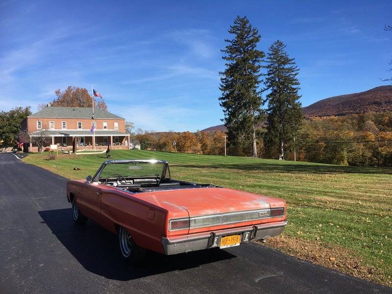

I have these on my 67 Coronet.
https://www.amazon.com/Hankook-Optimo-H724-All-Season-Tire/dp/B004QL6ASA
26.7" tall.
