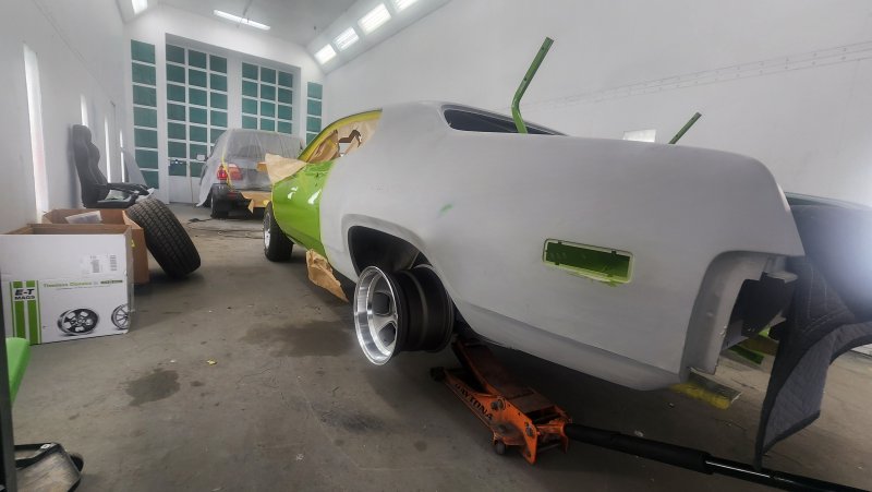

Has anyone ran 15 x 10s on their 71 roadrunner and can it be done, if so what backspacing is needed?
Stock length 8 3/4

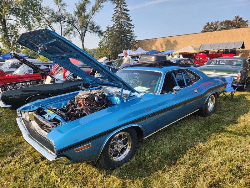

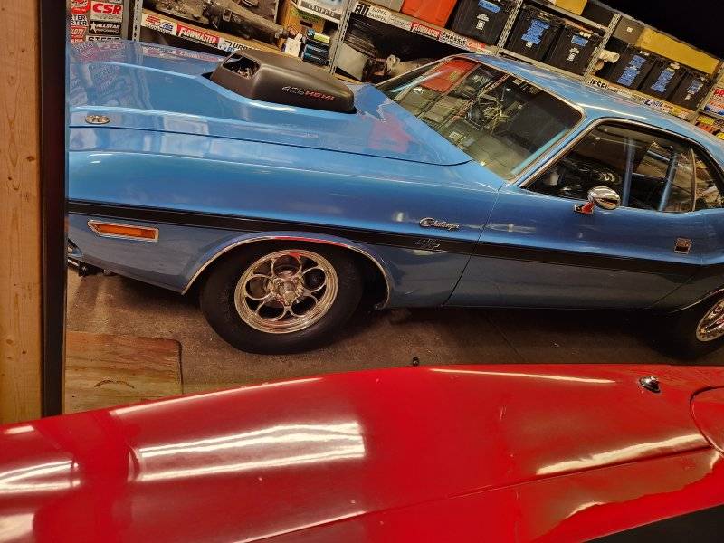

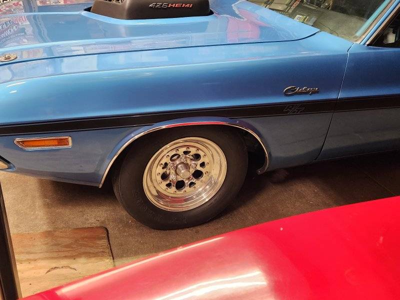

I run 2 different front runners on my cars. Both are 1-7/8" b.s. Currently, they
happen to be on my Challenger.
