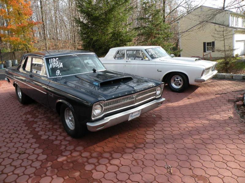

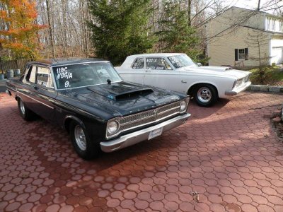

I have in board springs with no mini tubs on my 65 Coronet with stock width axels. I was able to fit 29x10.5W w/6.5" back spacing on 10" rims. I would think with mini tubs I could get another 2" of tread on the ground but 10.5w is the widest tire allowed in NSS racing around here anyway.

same exact setup on my 63 Plymouth max wedge savoy.
